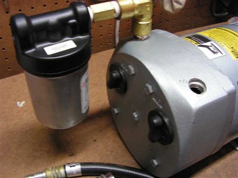

Here's my setup -- a GAST 120v pump that I purchase about 10 years ago. I cleaned it thoroughly by simply removing the front pump cover and getting in there with a toothbrush and rags to get the residue. In most cases the residue is simply carbon dust from the pump vanes.
I added a canister filter housing and filter element to keep the carbon vane dust out of the airlines
The filter was purchased from Zoro and the housing from PKSafety (although any air-line filter cannister and cartridge would do).

For convenience sake I also added a pressure regulator to the paper filter outlet as an additional screen filter to trap any residue that might make it past the first filter, and to regulate air pressure on shorter air hose runs so that the mask doesn't become too pressurized around my face and cause air gaps. I later scrapped this extra filter because it wasn't really necessary -- one good filter cartridge is sufficient.
That's it -- it works very well and just as efficient as one of those commercial $1200 units that only use a 1/4HP pump -- mine has way more capacity and in a pinch I have hooked up two masks when I team painted a trailer several years ago with a friend. We were both supplied clean fresh air. My system cost me a bit more than $100 and it's based on the same GAST pump design that the commercial systems are. It did take a few weeks to find all the pieces on ebay at reasonable cost, but the wait was rewarded with good deals.
