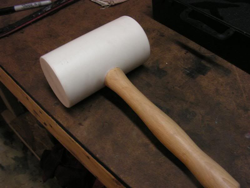

This is 1/16" lead sheet that I keep around for gas tank soldering. I cut an appropriate patch to size with tin snips and start to prep the sheet.
The bulk sheet must be made stretchable by hammering and flattening sheet until it becomes wider, thinner and more flexible. It takes a flat faced hammer to expand and stretch the lead into a proper patch. Then the patch is formed to match contours of the lower tank corners. At this point you can form it pretty much by hand.

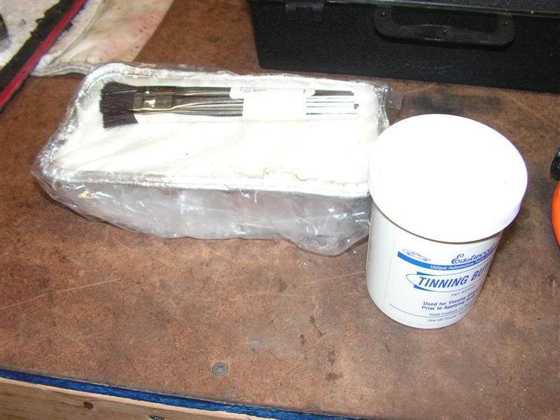

Then the metal is first cleaned with a strong solvent and then the area is tinned with some body soldering "tinning butter"

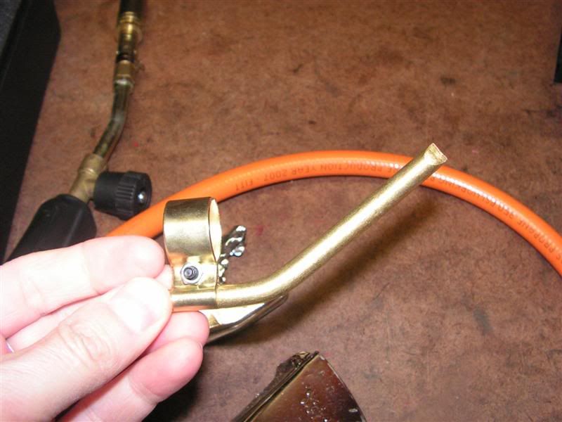

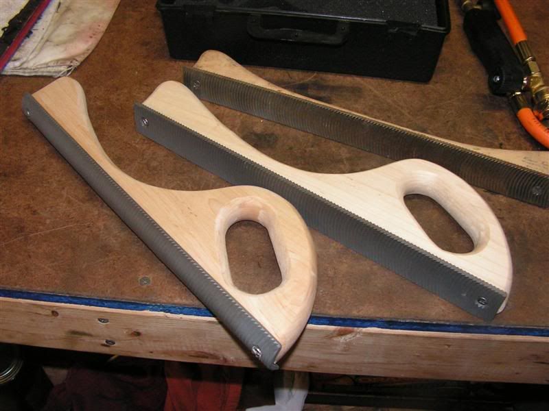

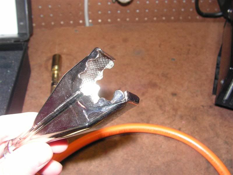

Next I use my propane torch and a lead body solder bar to solder the patch along its seams. Once the soldering is done, I give it a quick scuff with a 60 grit sanding disc and make sure all the seams are nicely filled in.
