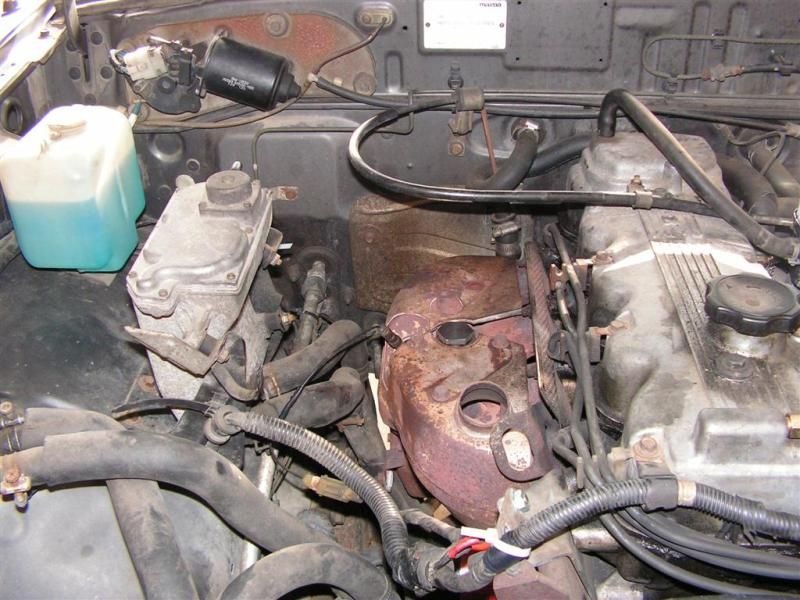

Started stripping the engine of "smog" equipment and lines today. Essentially, all the electronic fuel management will be removed, and the Weber will function like a normal manual intake system.
It's amazing how much emission control crap was on this little truck; a wonder that it drove at all. Gulp valves, metering valves, fuel solenoids, vacuum switches; the list is endless and the vacuum lines are never ending. Just look at this mess.
It did clean up the engine compartment pretty well though. Now it actually looks like a normal engine --
The emission recirculation port on the exhaust manifold was removed, and since I didn't have a plug this size, I cut the tube and squeezed the top shut in a vise and welded the seam closed. It makes a good seal and the entire manifold is tight.
ADDITIONAL NOTE: This last step wasn't necessary. The Weber kit did include two large manifold plugs for plugging the two large ports in the exhaust manifold (one on top and the other towards the rear of the manifold). The best way to remove the old lines is to use a cutting wheel or sawz-all to cut the metal tubes right above the fittings, and then heat the fittings with an O/A torch to loosen and remove them. Without that O/A heat, no amount of penetrating oil would budge those rusted fittings.
Alternatively, you cab just cut the tubes above the fittings and install a short piece of rubber hose on the stub, then plug the hose with a large bolt or other makeshift plug.
Don't even need the O2 sensor anymore. I'll just disconnect it at the plug and bundle the wire.

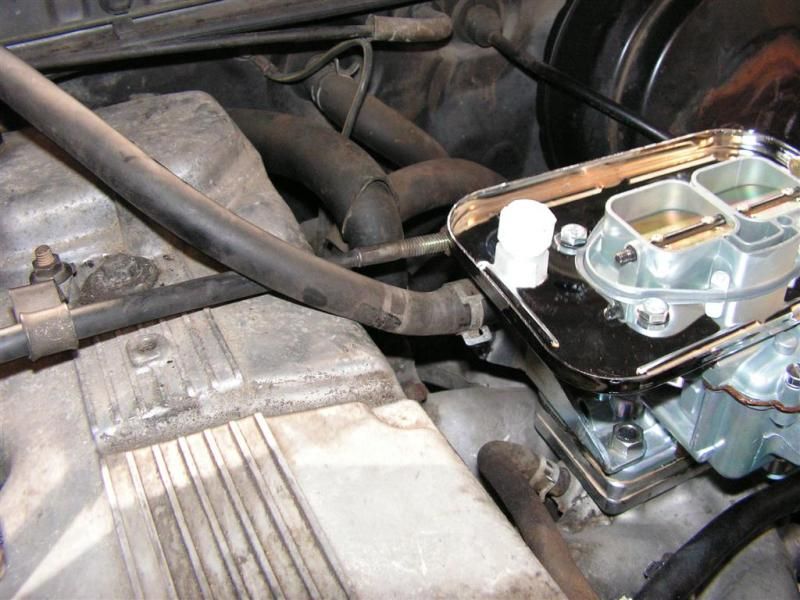

The carburetor is installed on the studs and the throttle cable is hooked up. The only large mod that I needed to do was to raise the throttle cable mounting clamp that was included in the Weber kit. It is mounted on the back of the carb and was sitting too low thereby binding the throttle cable. I simply welded a piece of 1/8" thick steel on top of the old bracket to lengthen it. Then I drilled another throttle cable mounting hole to accept the cable. This raised the cable to a height that allowed smooth operation.

So this morning I installed the air cleaner, breather, and routed the hoses and wires in a more efficient manner. Lots of zip ties, rubber grommets and tape were used to tidy things up.
First the air cleaner element that came with this Weber kit is top quality. However, because of my breather fitting location I mounted the element in reverse. It fits, but on some applications it may not. The breather fitting is screwed into the bottom, and bolted on the throat of the carb.
A nice thick gasket was included in the kit.
Final routing was accomplished by going straight out the back and over the accelerator cable.
Final routing of the vacuum lines and the electric choke was nicely bundled and secured
