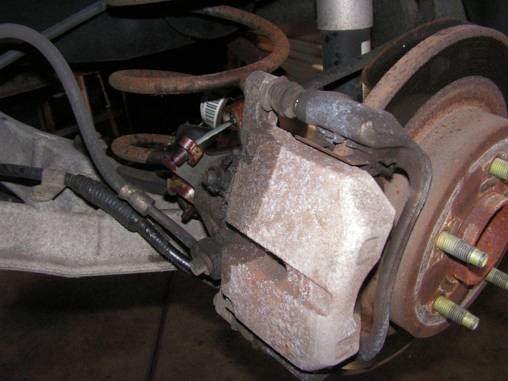

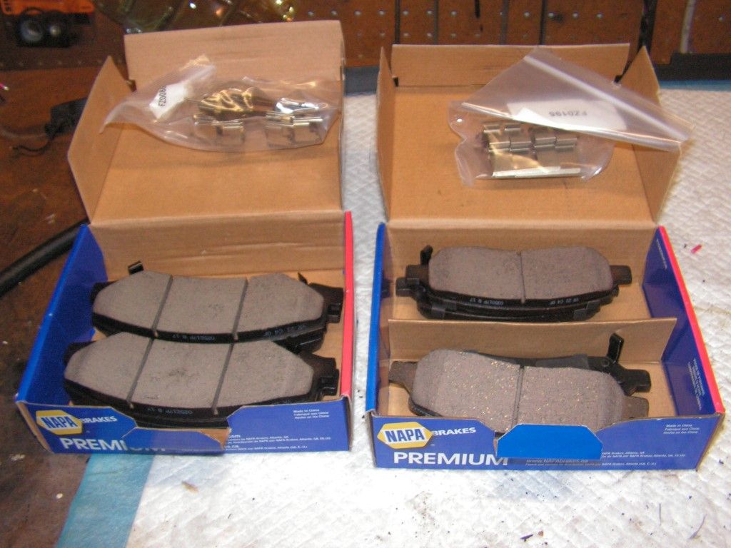

I knew when I bought it a few months ago that it needed brakes. The rears were very worn close and I decided to do the fronts as well since I don't want to tackle this job in the winter.
.. both from and rear rotors has slight surface rust, but they checked to spec using a thickness gauge -- so I only wound up putting on pads.
The rear caliper bolts were a bit tough due to some corrosion, but with the help of some Kroil they came out fairly easy.
This is why I like NAPA; they include very nice hardware in their Premium brake pad sets. Discount places usually omit the hardware
The slider pins were dry, and after a good cleaning and lube they were smooth as silk again.

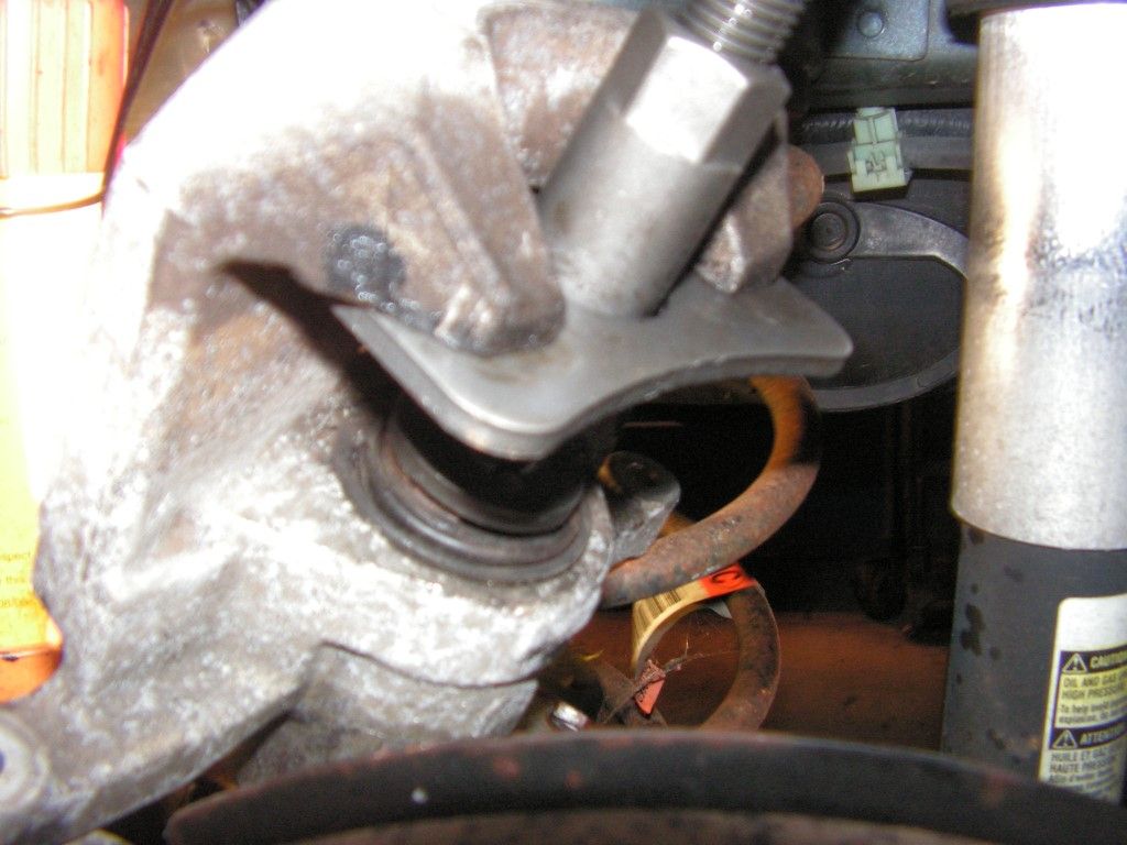

The only real issue with these is the parking brake mechanism that needs to be turned clockwise to retract the piston. A special tool is required, or in some cases if the piston is loose, the front end of a pair of needle nose pliers can be used to turn the piston.

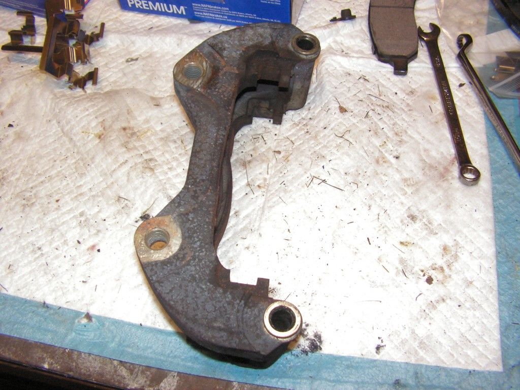

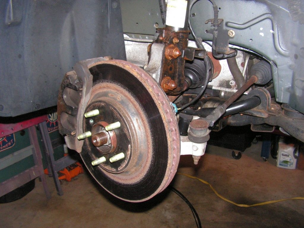

The fronts were a bit more difficult because both slide pins were sticky. I had to remove the entire brake caliper bracket -- and it was tight. The loctite that the factory uses is pretty strong. Had to use my 1/2" drive impact to get it lose.
The bores were full of sticky gunk and I cleaned them with out with a nylon bore brush and carb cleaner. Then l lubed and cleaned all the pins and the whole assembly was smooth again. I think this is why I was getting some brake noise before -- because after this install, the test drive was perfectly quiet.

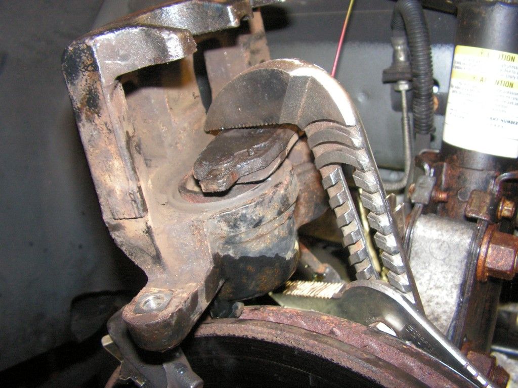

The caliper was easy -- clamp the brake line, open the bleeder and use an old pad along with some big channel lock pliers to push the pistons back in their bores.

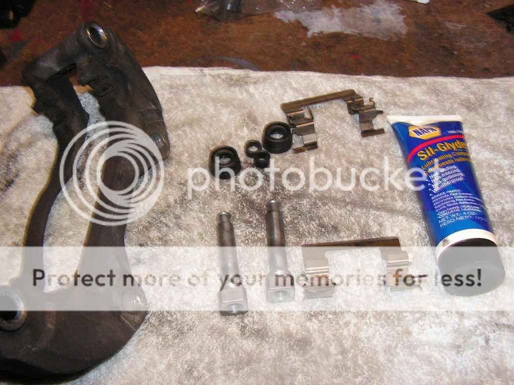

I usually use CRC brake grease on most of my cars, but in this case it's not the right solution. These GM calipers have neoprene bushings on the slide pins and after just a few months since I replaced the brakes, the grease has caused the bushings to swell, and the dust boots to deteriorate. There's something in that brake grease that isn't compatible with these GM designs.
The solution is to remove the caliper bracket and clean it thoroughly in the parts washer, with special attention to the slide pin bores. Then lube with NAPA Syl-Glide silicone based brake grease that doesn't react with the neoprene bushings and cause swelling.

Everything cleaned and ready for reassembly -
