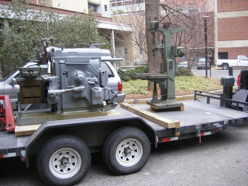

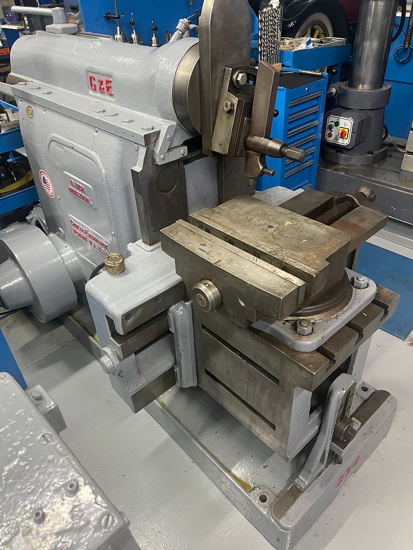

I was looking for a 7" shaper for years. You could easily find a full size one for less cost of the 7". That in my mind always asking too much. Twenty years ago I received a PM on another board for this 16" Gould & Eberhart from a University. They asked for a $500.00 donation made to the University. So I hooked up my flatbed trailer to my Avalanche and drove 1,000 round trip to pick it up... In a snow storm..
The Allen drill press/taper came along for the ride...

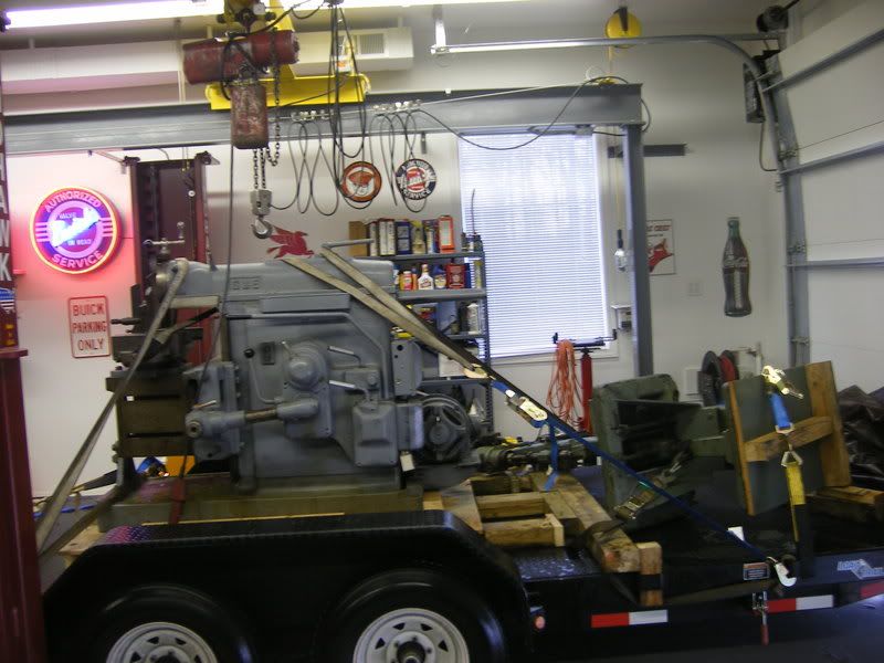

Lifting it off my trailer and putting in place. The G&E weights 4,500 pounds compared  to a 7" Atlas 300 pounds.
This shaper came off a WWII battleship and was not abused. And came with a 14" vise that's worth more than the asking price... That has many uses around my shop.
