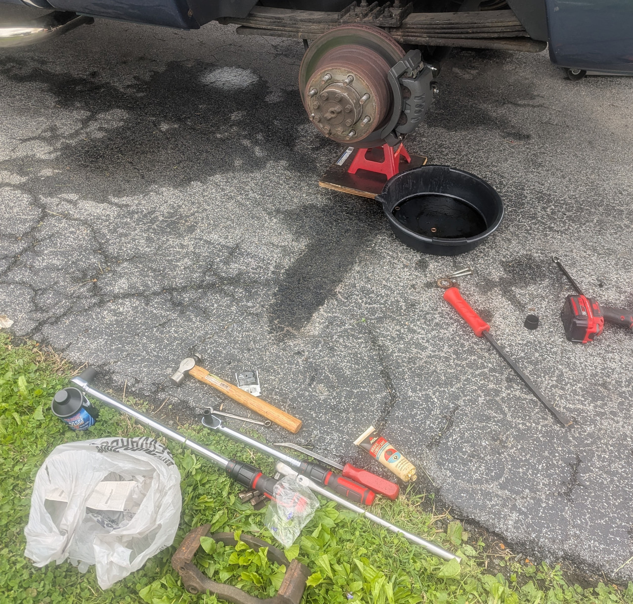

Next I got to see why the LR caliper seems to be sticking. Owning old vehicles is fun....

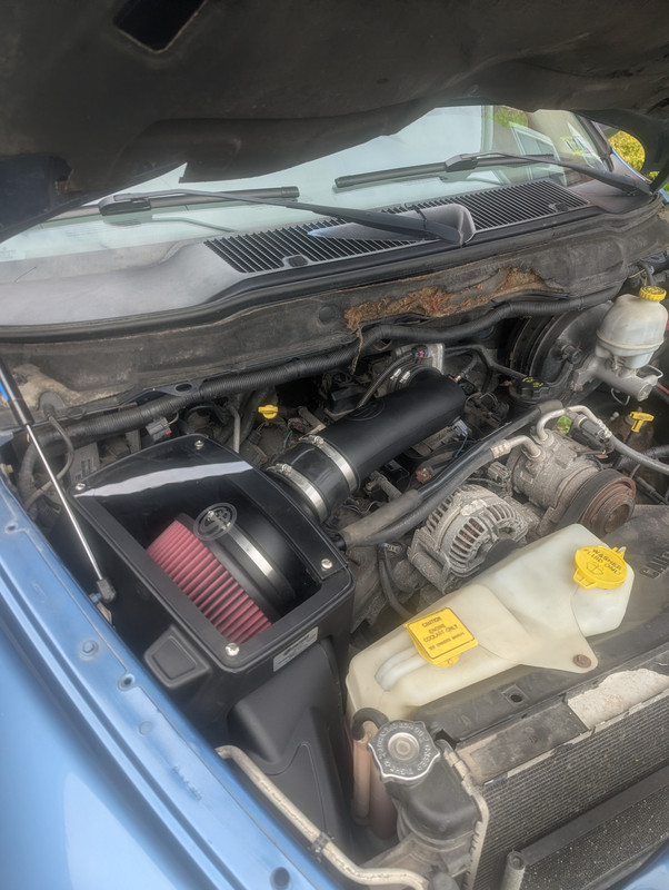

Turned out to be the caliper changed it out Sunday morning. Also installed a new air intake setup.
