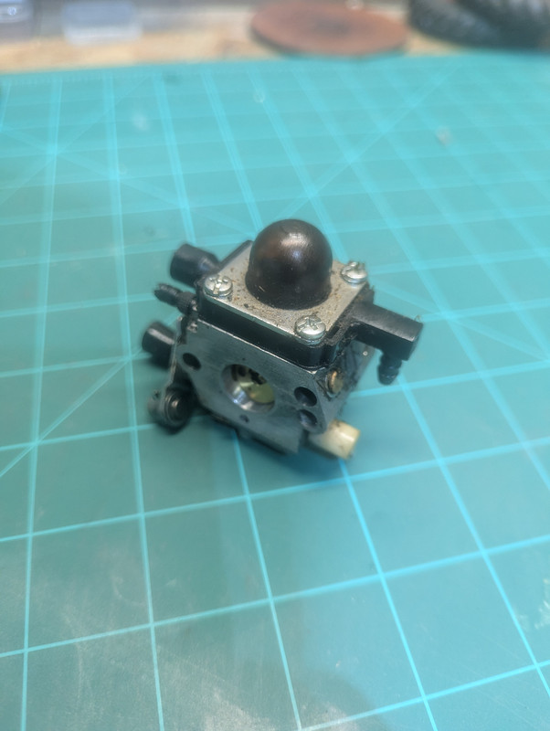

Carb on my weed whacker is acting up. So I took it apart to put in the sonic cleaner.
