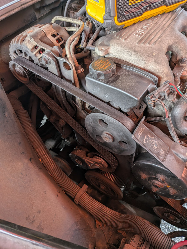

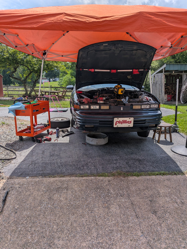

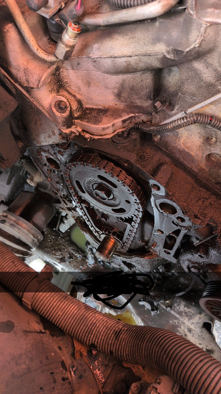

Did the timing cover gasket and water pump in my daily junk.

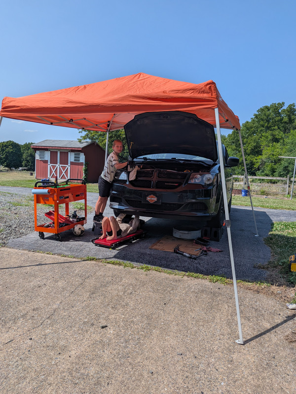

Saturday I replaced the VFS (variable force solenoid) in the van. It's not shifting funny and hunting for torque converter lockup.
Well see if it helps. Just trying to prolong the inevitable.
