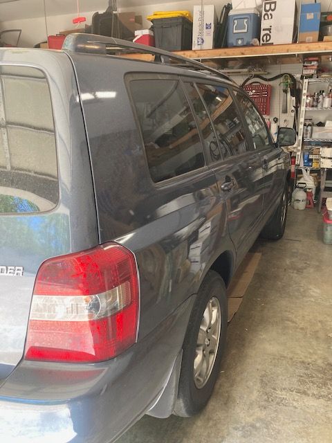

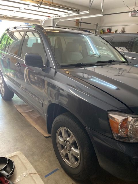

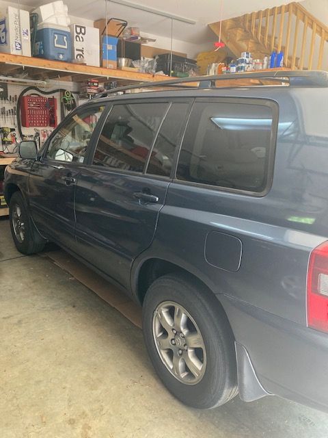

Here's the Highlander --

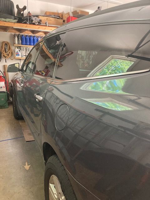

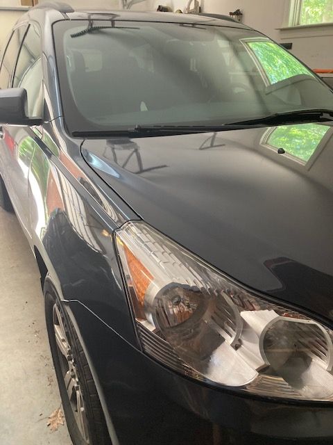

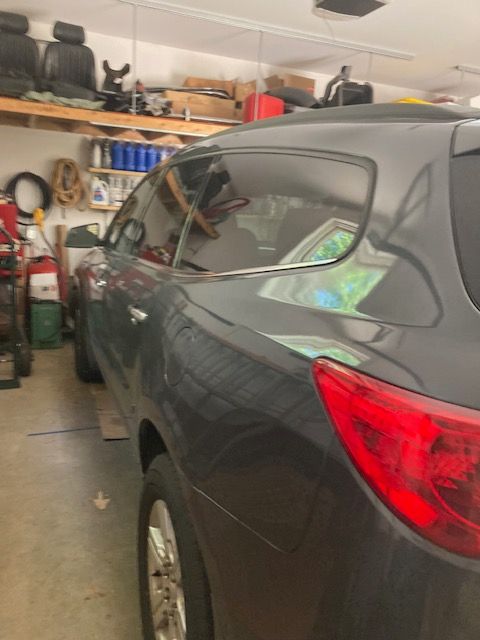

...and the Traverse
As in most things, the prep work is the hardest. The paint reflects the effort in the prep. That's why it took me almost six weeks to get these cars ready for paint.
I'm pretty impressed with MAACO and can definitely recommend their service for these types of jobs.
