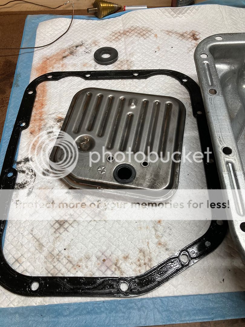

Dropped the pan and the fluid was dark and smelled bad, and a good amount of material on the magnet as well.

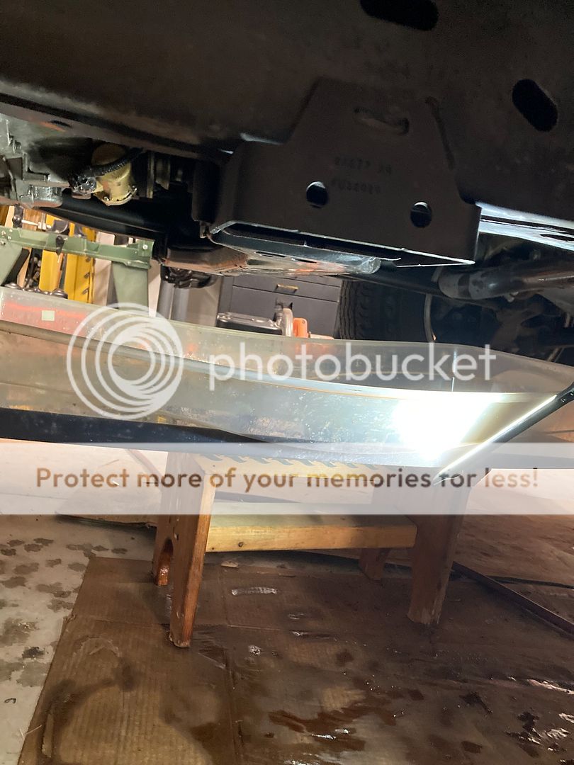

This large under-bed storage bin has been my go-to drain pan for transmissions for decades. No spills and no mess. Put it on a small stool and it catches everything.

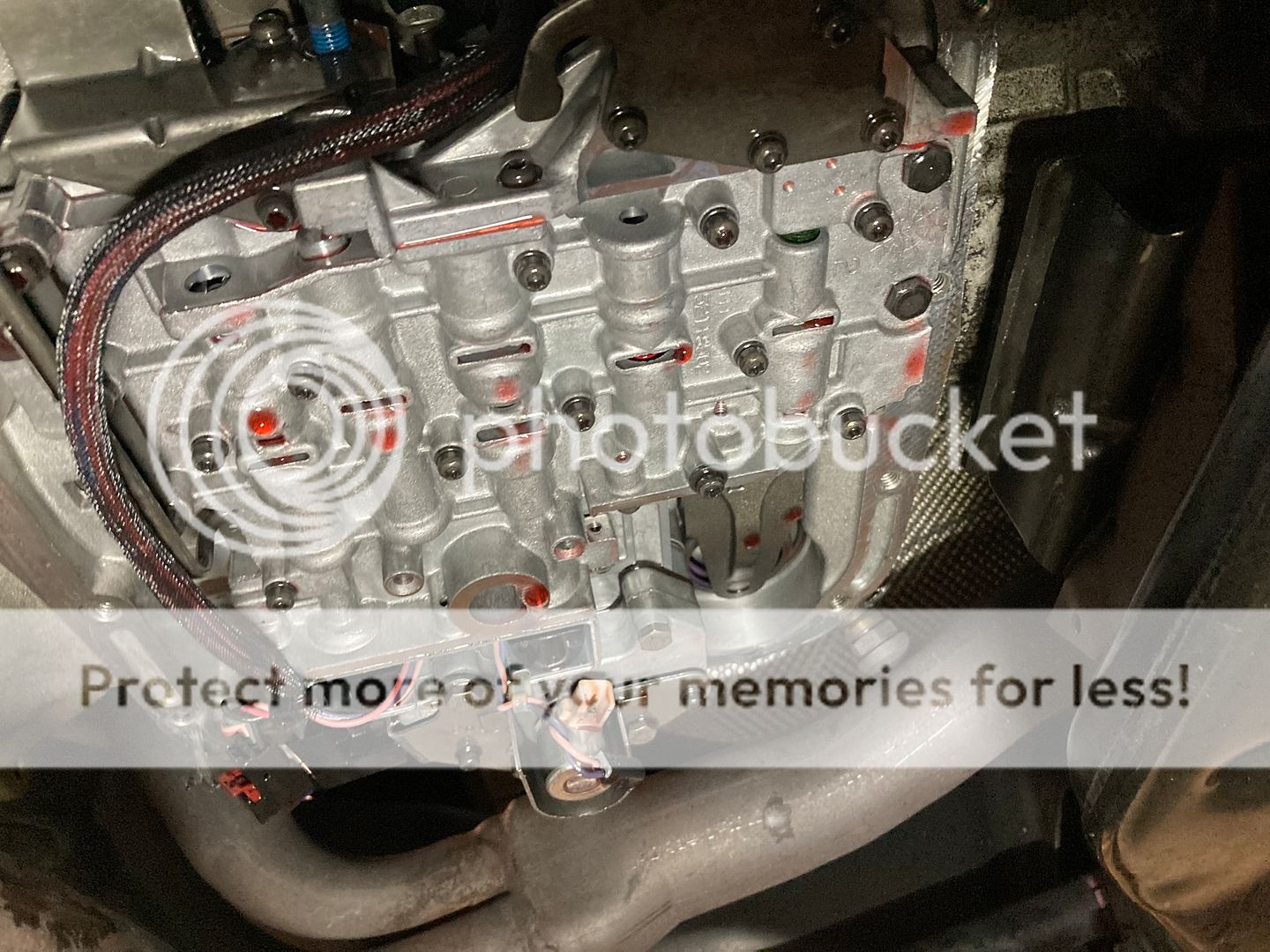

Valve body looks good

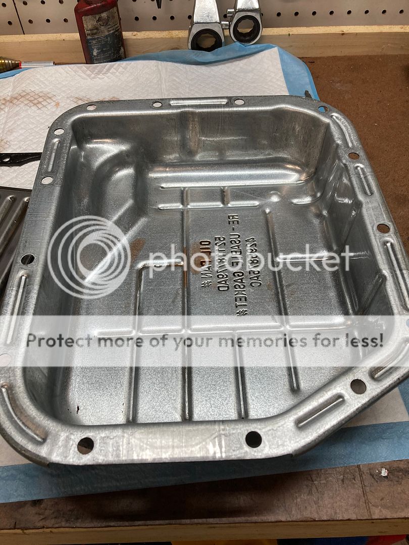

old pan and gasket looked in great shape, but I replaced both with a pan that has a drain plug and a flexible gasket vs the OEM rigid gasket (which leaked a bit.

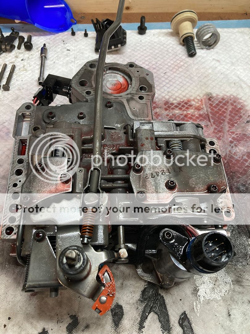

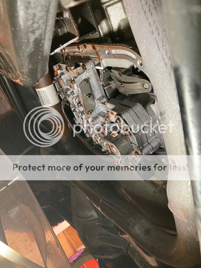

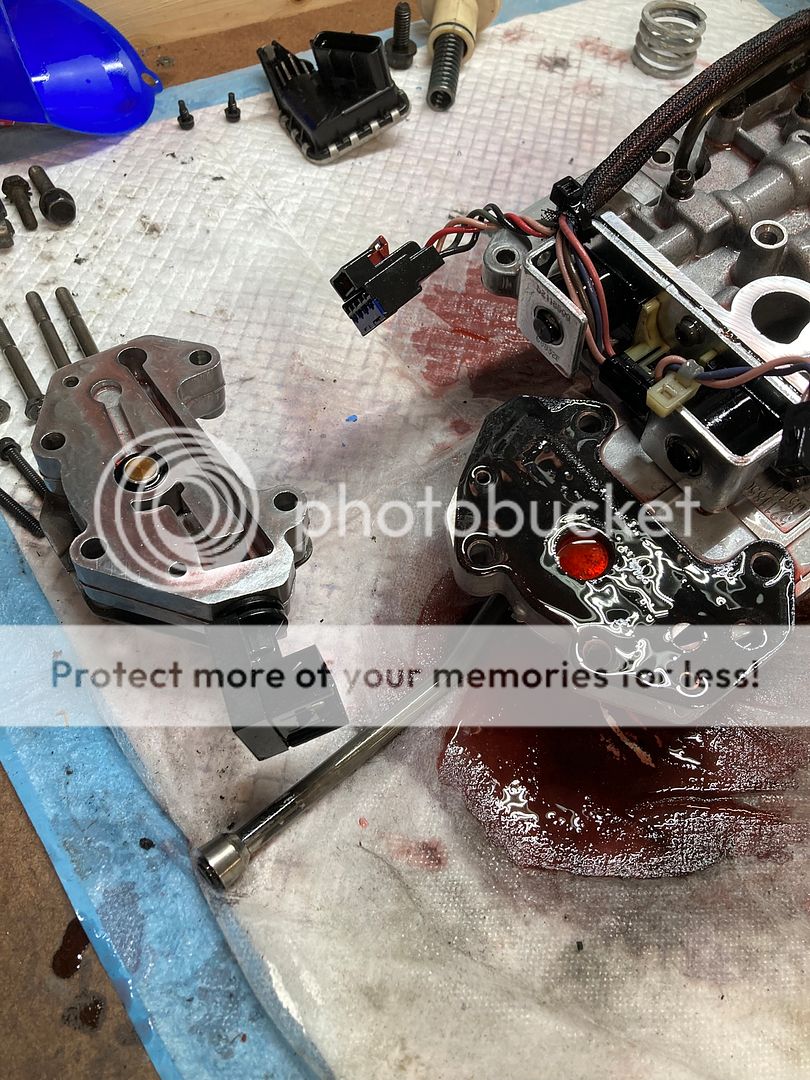

I love my job, that's why I do it twice -- words to live by! The code came back and it turned into a hard fault, not an intermittent fault. Time to drop the pan, disconnect the shift linkages, and drop the valve body. Oh Joy!!
This is the new replacement -- commercial grade from Advance Auto and made in Taiwan. I stay away from Chinese and Mexican solenoids and electricals -- been down that road too many times.

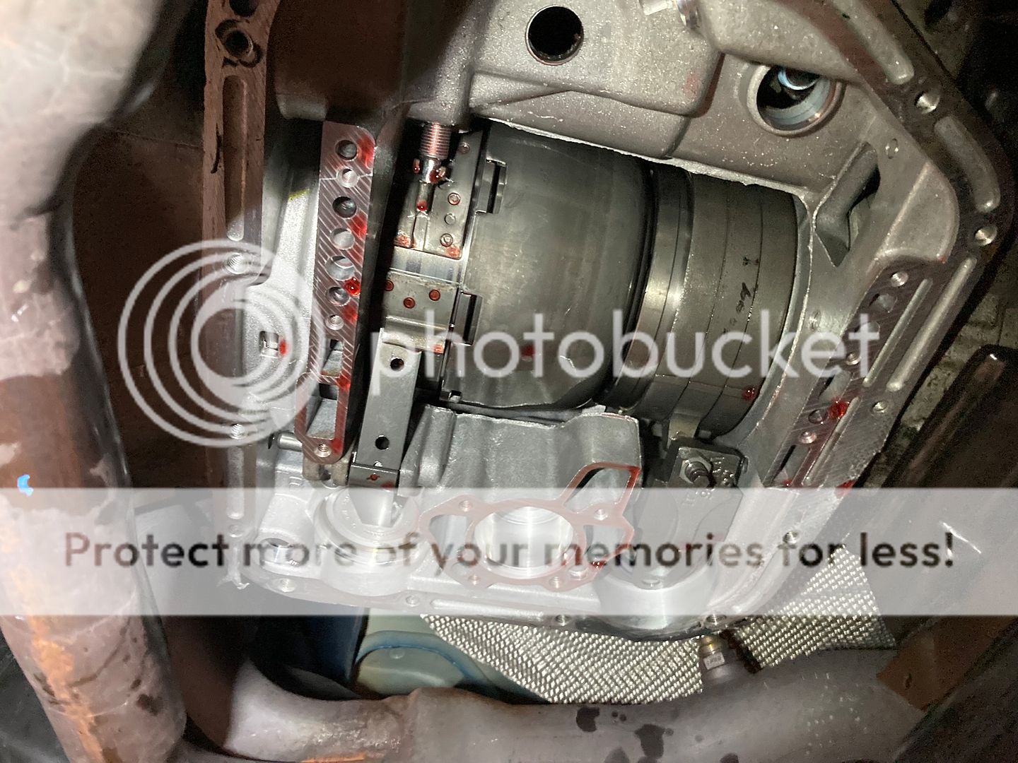

Band and drum look like new
I'll try to get this done by Monday. I just can't move as fast as I use to. Slow and steady is my speed these days.
That would be way out of my depth I suspect. Fluid and filter changes and i recall once changing a vacuum modulator (I think that was the name of the part) anything more in depth than that goes to the tranny shop for me.
It's not that difficult of a job Herb -- IF the transmission is out of the vehicle and sitting on a bench, this is a cake walk.

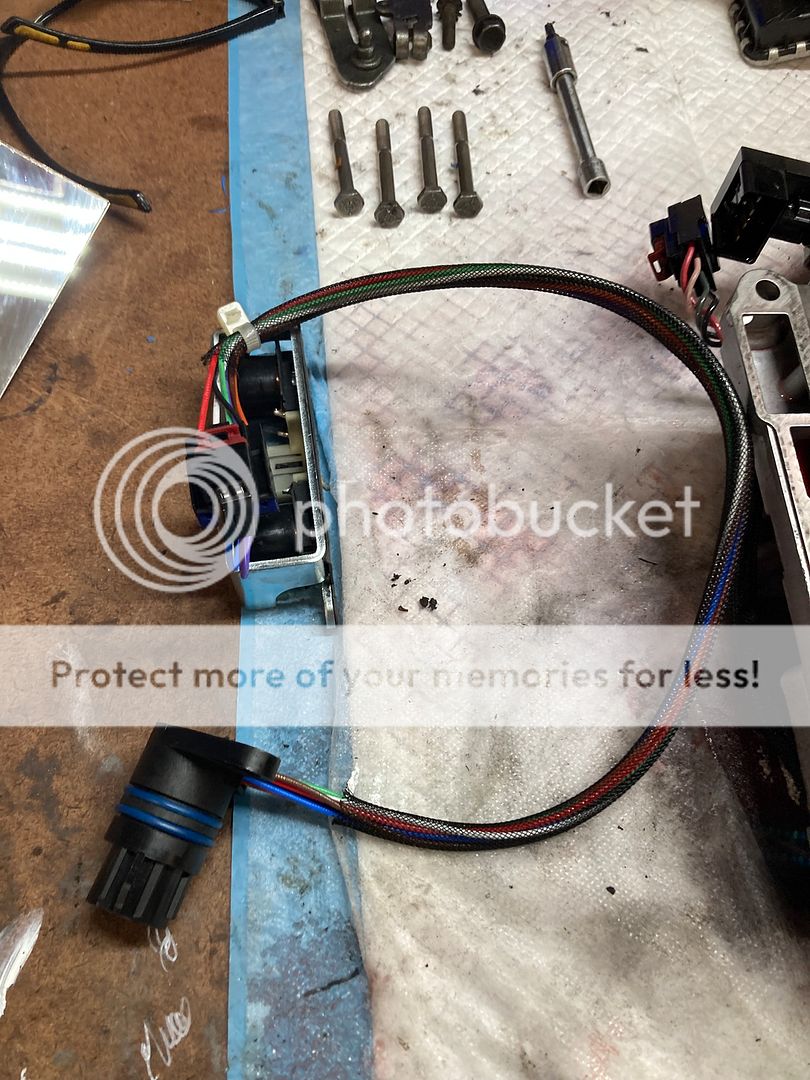

With the transmission in the truck and the fact it's a 4x4, disconnecting all the linkages and plugs to gain access to the external shift solenoid electrical connector is a challenge. The shift solenoid harness connects to the outside of the transmission, hence the female portion of the plug pulls out with the valve body. That task really is the difficult part of this job.
I finished up an hour ago and cleaned up the garage. I'll wait for the Permatex Ultra Black transmission pan gasket sealer to cure for today to make sure the pan doesn't leak. Tomorrow I'll fill with 7-1/2 qts. of AFT-4+ and hope this issue is resolved.
 I measured all the fluid that came out, and 7-1/2 qts is a starting point (give or take)
After a few days of driving it on a regular basis, the shift/lockup solenoid replacement seems to have been successful.
