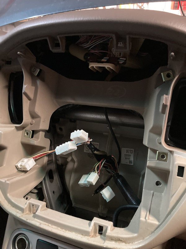

This is a known issue in this generation of Highlanders. The ribbon cable from control board to the rotator POT develops breaks in one or more of the three thin wires and the car can't turn on the heat or cold settings. The solution is to remove the entire control unit along with the radio and either re-solder the ribbon cable, or solder on new wires. I chose to solder more sturdy and robust 20 gauge wires.

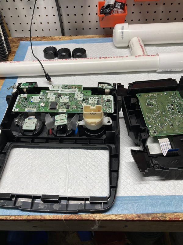

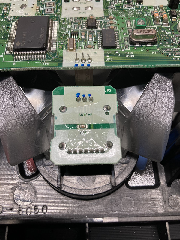

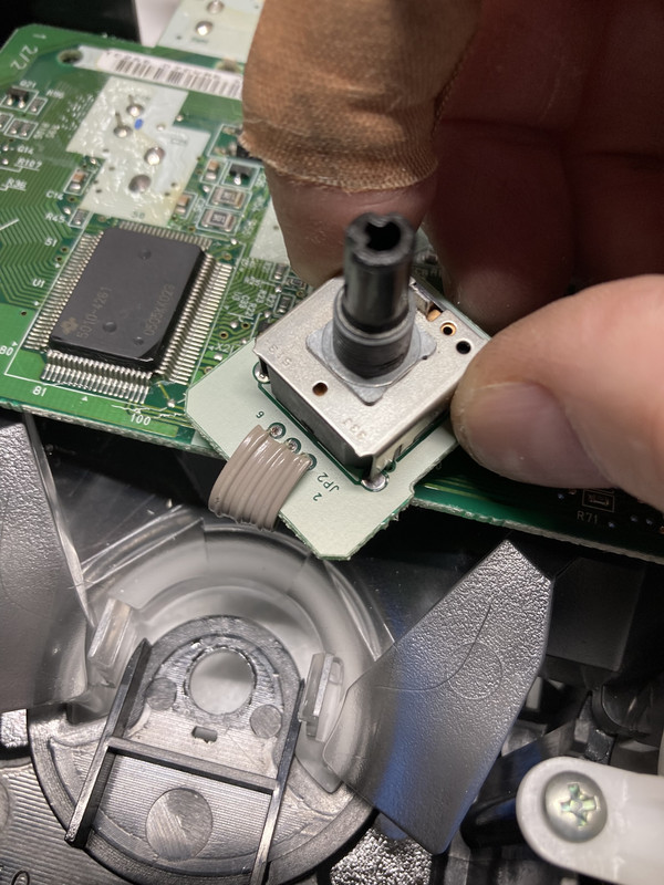

Disassemble the control unit and loosen the POT
Clean up the solder point on the POT and prep for new solder.

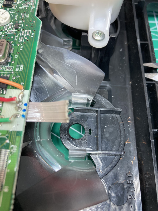

I just cut the old ribbon cable and soldered in new wires (more robust that way)
Reassembled everything and this old unit is good to go for a few more years. One thing is for sure, in my old age keeping a steady hand on the soldering iron is not that easy anymore. --- LOL -- oh well!!
