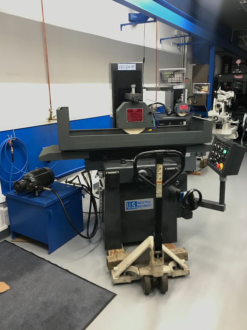

Moisture, oil, and dirt are the enemy in any compressed air system. Each tank has an auto drain valve at the bottom that's timed at 30 minute intervals to drain off any water in the tank. The compressed air first passes through a coalescing filter that removes water and oil contaminants. Before entering the refrigerated air dryer to remove any moisture. A second filter before exiting to the shops in a 1" black pipes to each of my seven garages. Braided rubber hose run under ground through 2" PVC pipes to the other buildings. Two main 1" runs are routed on top of the ceiling joists of the longer walls. Most of the 1/2" steel drops are hidden in the walls, between the siding and drywall. Several locations where that's not practical. Copper pipes with soldered fittings run down the walls,, Just for appearance.
There are eight retractable hoses reels located throughout my shops. Either ceiling mounted or surface  mounted few feet off the floor... In addition there are a dozen air hoses simply mounted at working level on the walls.
