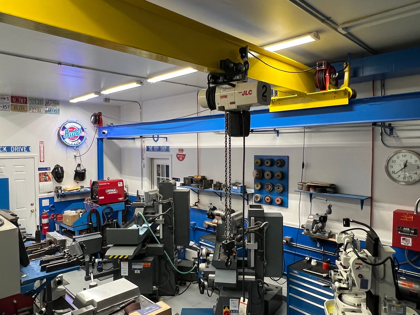

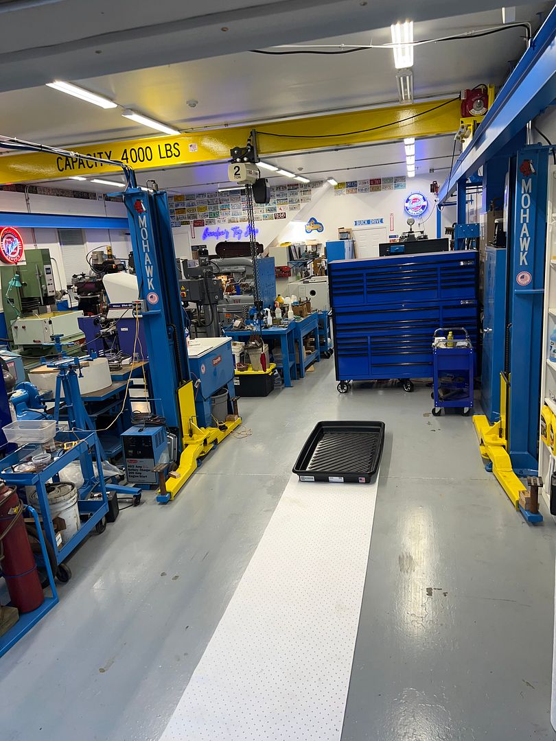

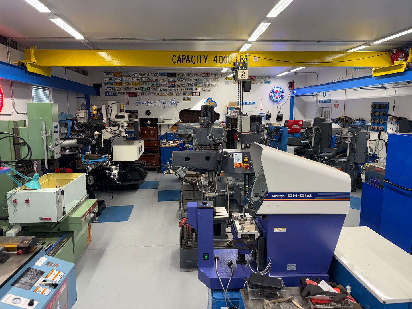

Looks outstanding...you obviously don't do stuff "halfway"!
The colour coordination throughout is also notable.  Too bad Milwaukee is red, though :-D
My admiration for Milwaukee power tools was long before they marketed to the masses. When they turned to using plastic, I become accustomed to red. And chose not to purchase Bosch or Makita. Same goes for Lincoln TIG & MIG welders.

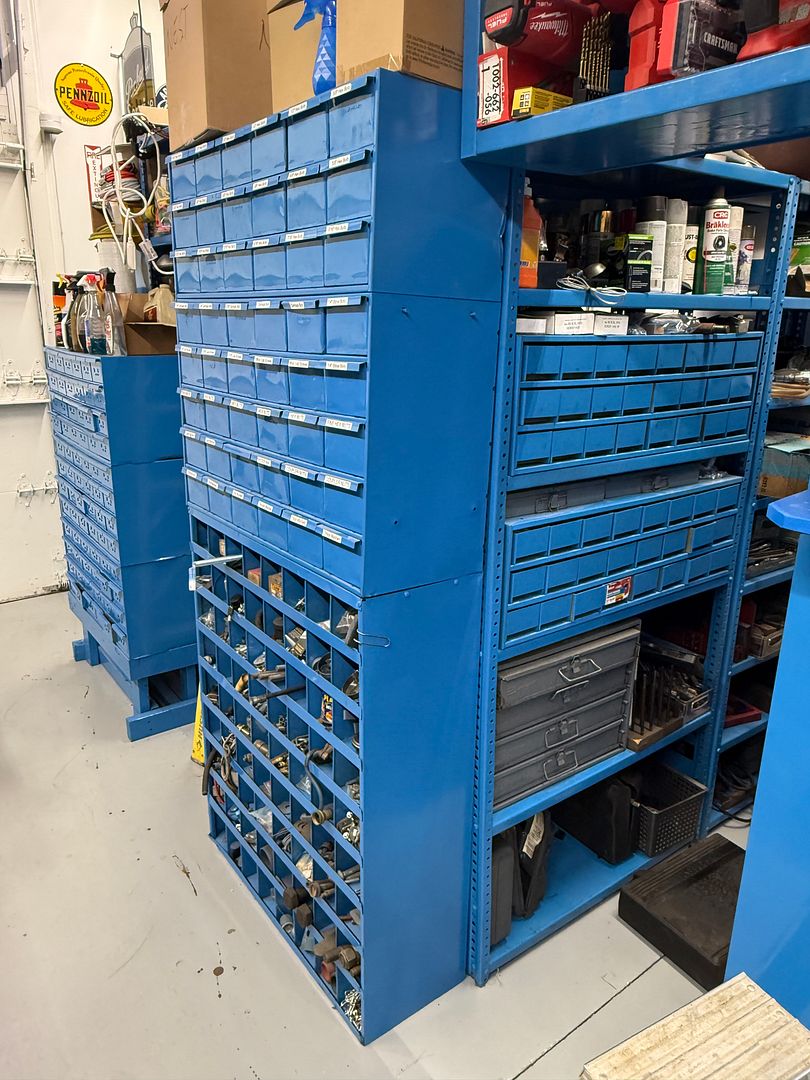

I build my garages for more than functionality. That are attractive and comfortable as my home. After all I spend a lot of time in them... Besides being heated and air conditioned. Having ample insulation in walls and ceilings. I fancy blue recognized by the wainscoting, cabinets, benches, shelving, and crane beams. Offset by gray epoxy floor coating. Walls and ceiling coated with white-Williams industrial pre-catalyzed water-based epoxy. For its' reflective quality and ease of cleaning.
