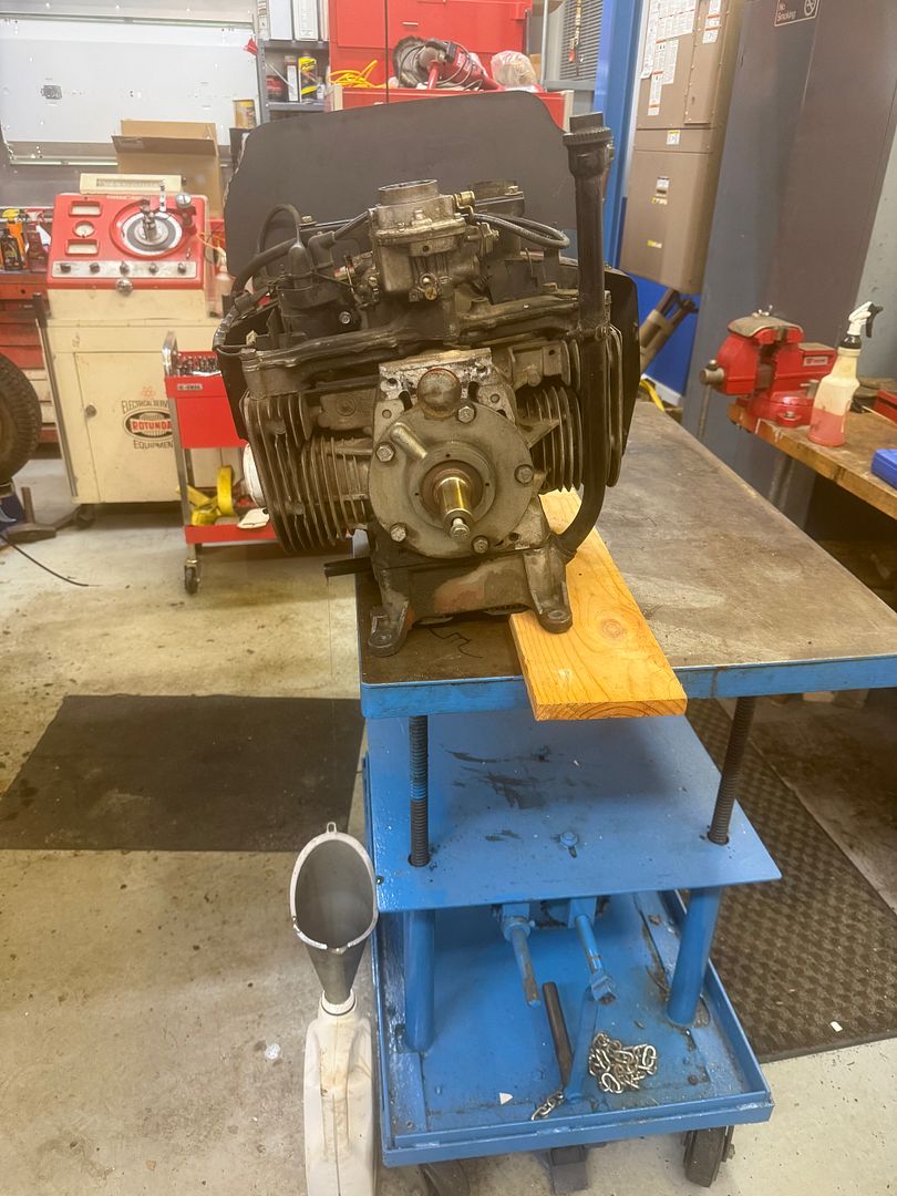

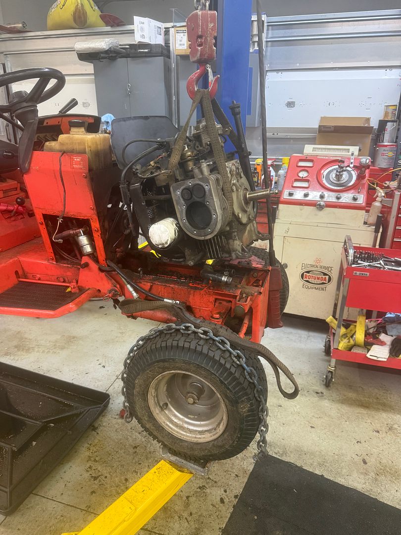

Having the 3118 on my lift made it easier to reach both the top and bottom side. Started by removing the oil exchange cooler. Then removing wires. Cables, starter, etc. I needed the remove the mowing deck to reach some bolts on the underside. A nylon strap and my bridge crane facilitated removing the engine. The set it on my elevated table, drained the oil, and started the tear down.
Setting the engine on my lift table. Letting the oil drain..

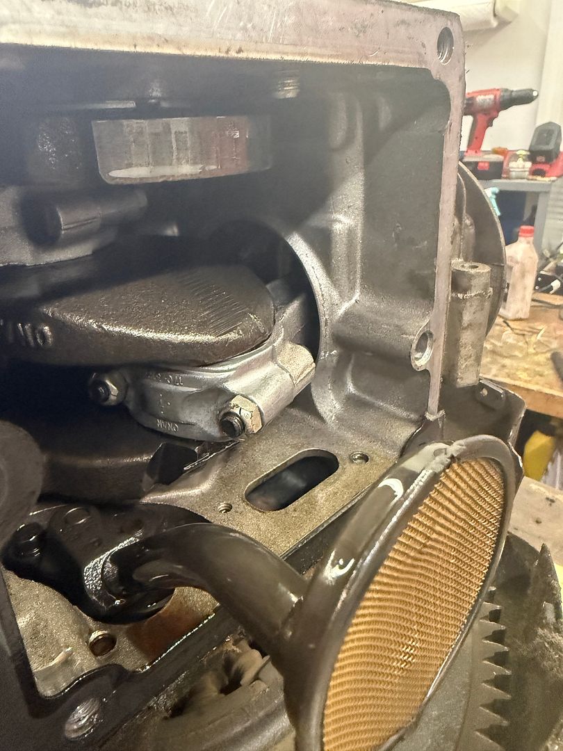

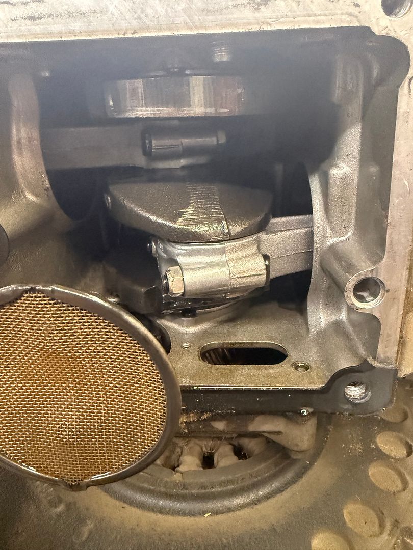

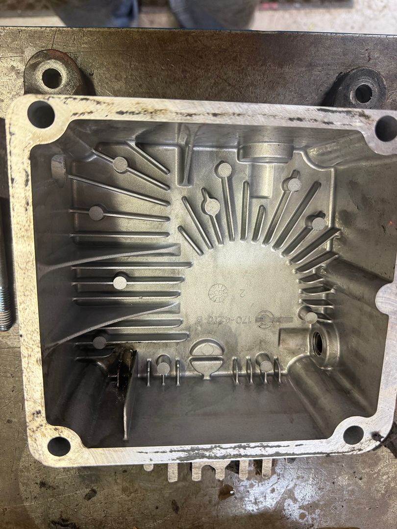

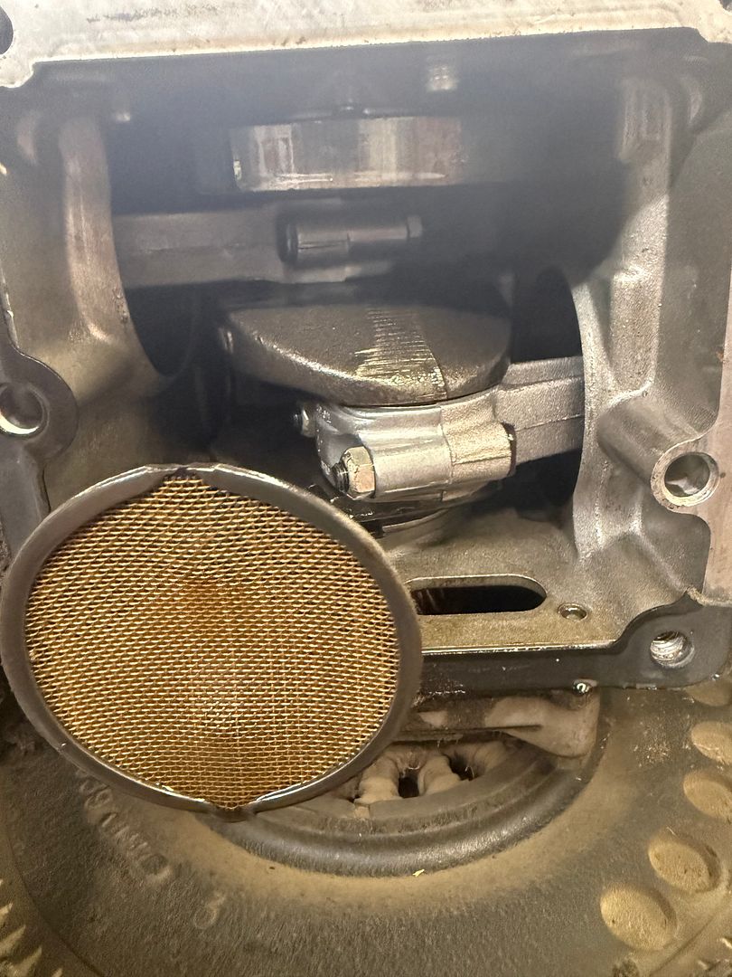

Removing the oil pan and see what's inside.. Looking GOOD so far..
Using good quality oil and frequent oil changes pays off! Even the oil is clean....
