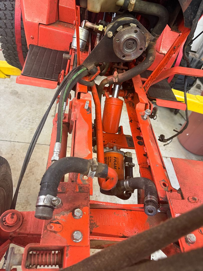

I disconnected the hydraulic pump from the engine. Diagnosing if it's the pump or the engine. Extremely close quarters.Took several hours just to remove four bolts.
Picture at another angle..

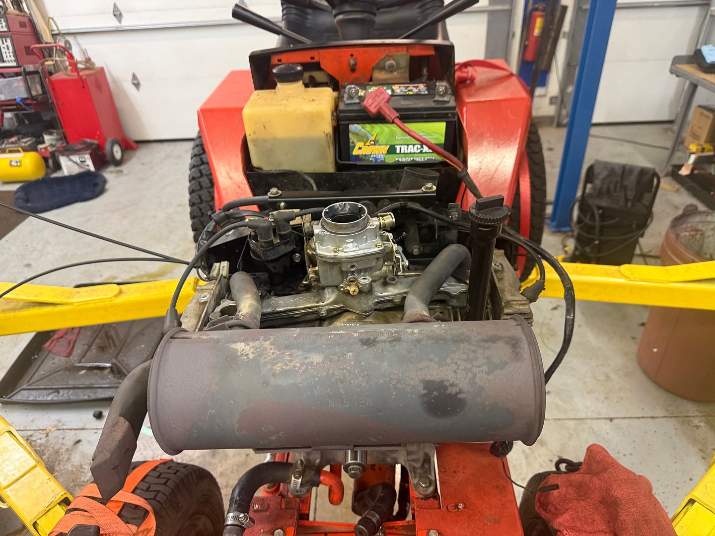

Still turns over slow.. Most likely the pump is okay. So the problem must be in the engine. Hope it's not all busted up inside!
Took another two hours to remove air filter and sheet metal shrouds.Then five minutes to remove the two heads...

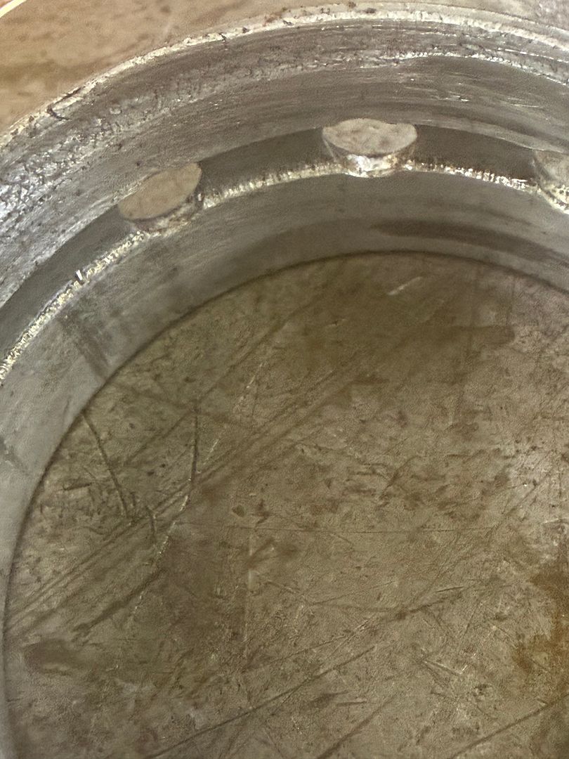

The cylinder walls look great.
With out compression the engine turns over a tad better using the starter motor. But I could hardly turn it over by hand. The piston go up and down. And valve action is good. I'll have to tear it down more to find the issue..

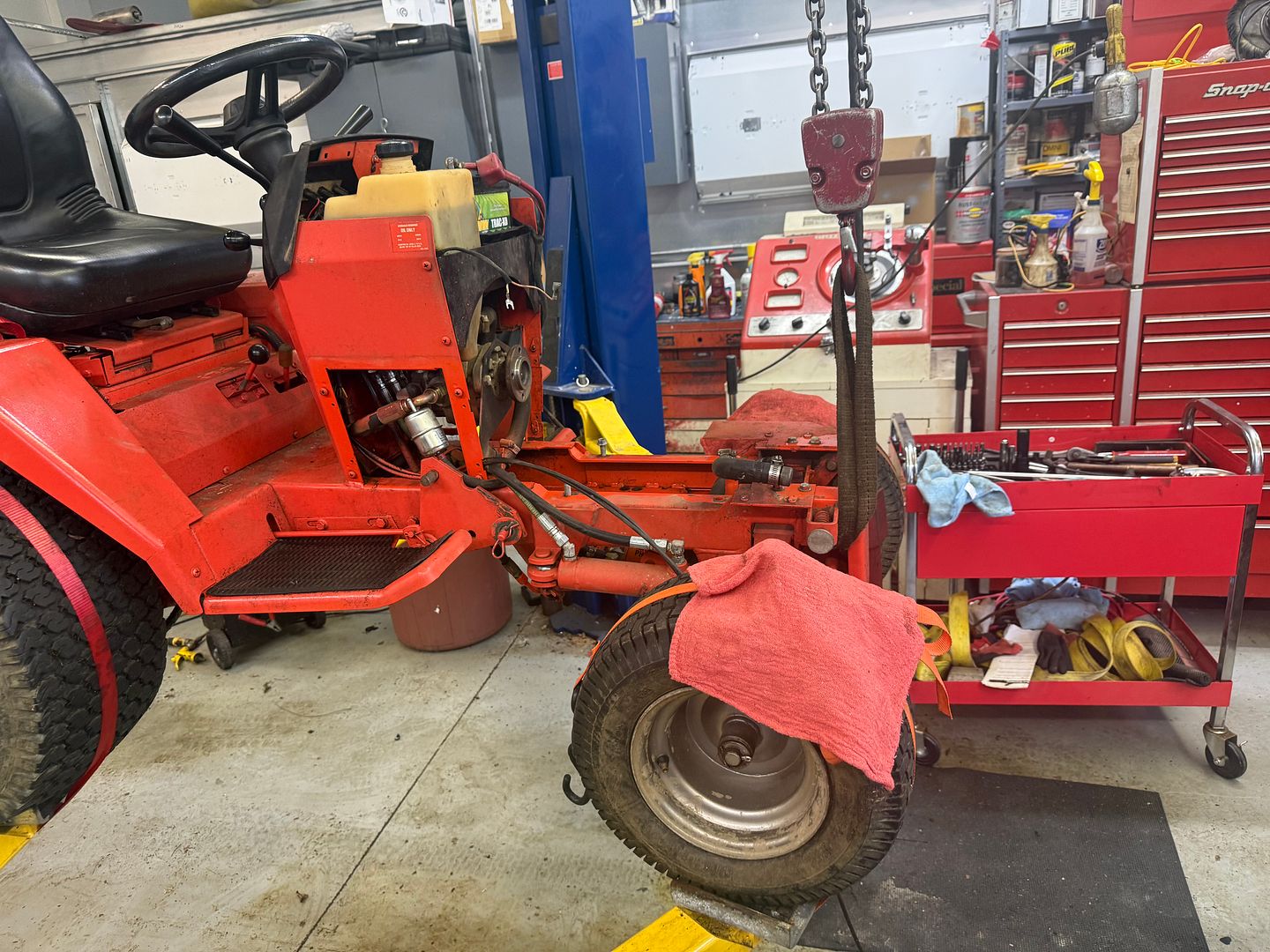

Having the 3118 on my lift made it easier to reach both the top and bottom side. Started by removing the oil exchange cooler. Then removing wires. Cables, starter, etc. I needed the remove the mowing deck to reach some bolts on the underside. A nylon strap and my bridge crane facilitated removing the engine. The set it on my elevated table, drained the oil, and started the tear down.

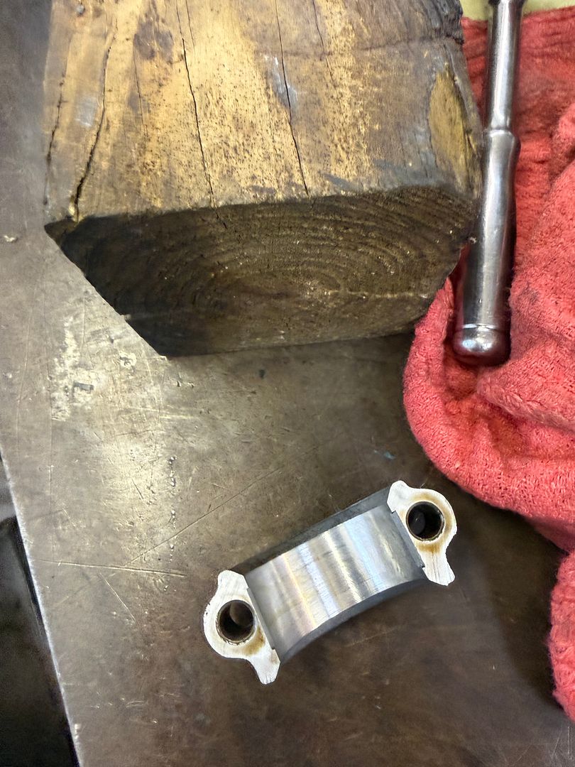

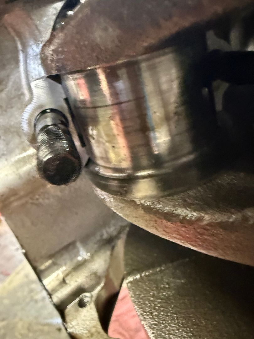

Once I removed the PTO end bearing cap. The crank turned freely along with the pistons and valve movements. The lower side of crank shaft journal is to size 1.999 to 2.000 diameter. The outer end picked up some babbitt off the bearing. That I should be able to polish off.
I'd say the bearing is toast and needs replaced. If bearings weren't readily available, as some of my antique cars. I would re-babbit the shell then machine... However the cost of a replacement doesn't justify...

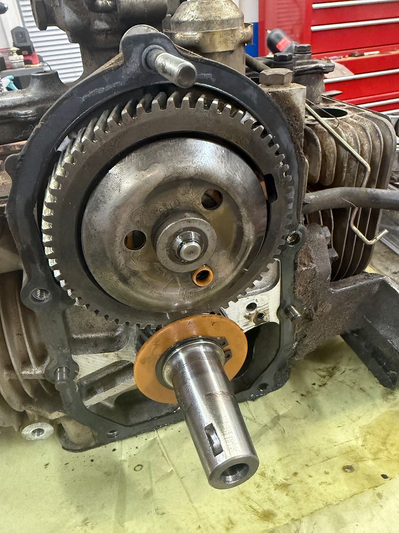

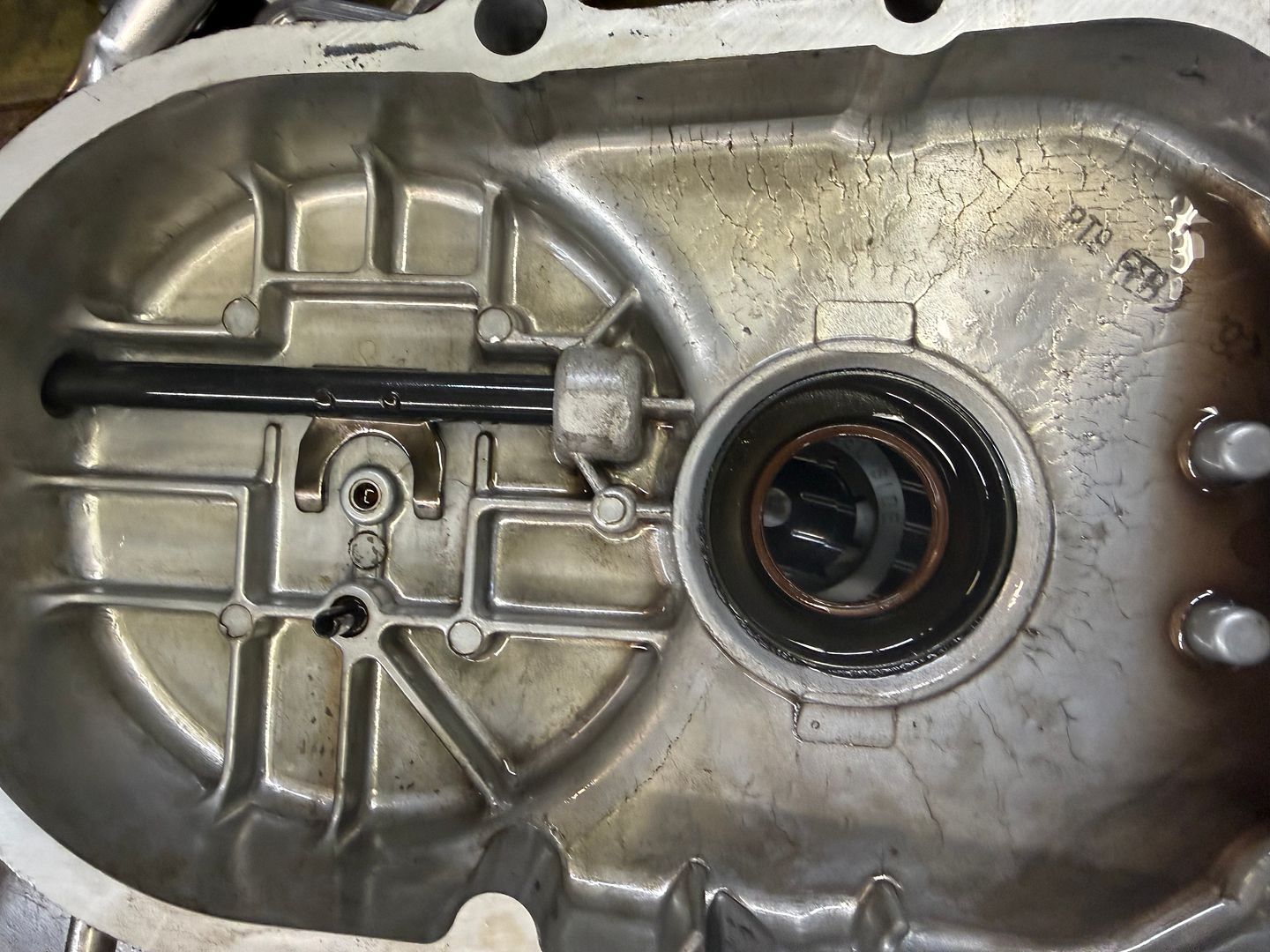

I have to wonder why the bearing was damaged. My inclination then was to look for the root of the problem... Removed the flywheel and cam gear cover. Once again it was clean as a whistle!

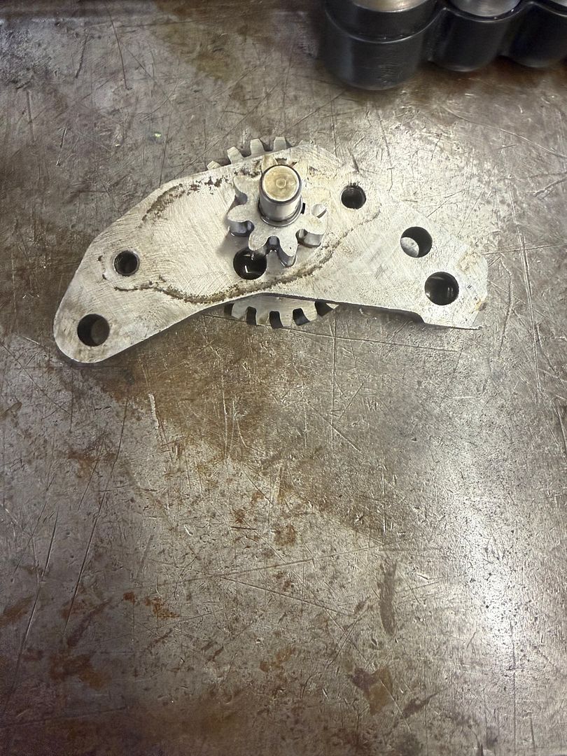

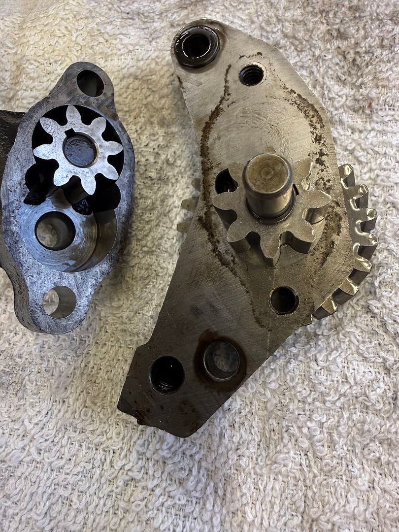

I noticed a small section of the gasket protruding between the halves of the pump flanges. Now why would that happen after 30 years? Removed and examined the oil pump components. No noticeable wear. The small gear key was intact. Could the missing section of the gasket cause loss of oil flow?  Since the damaged bearing was the farthermost from the pump...
In any event it was good thing that I didn't continue operating the tractor. Rather delving into the issue. I have the main bearing and all the gaskets on order. With any luck the old gal will be up and running i a week...

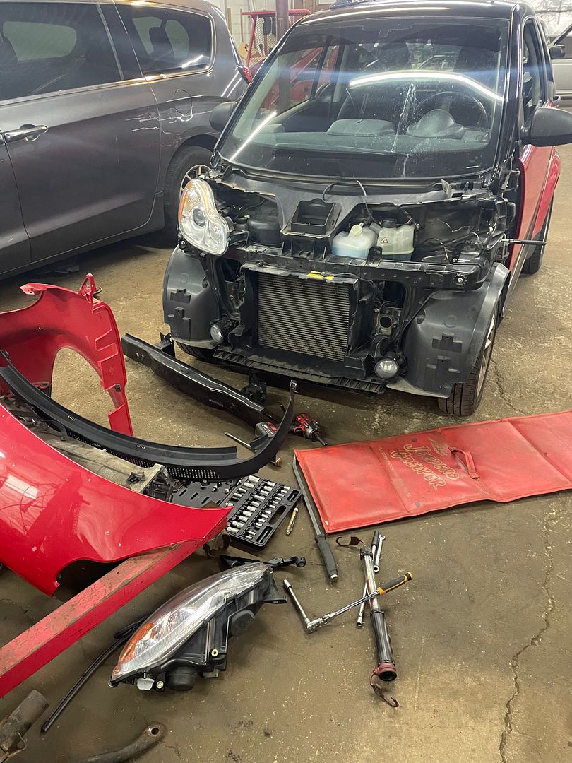

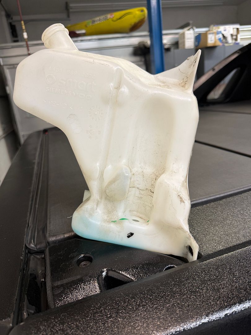

The Ingersoll tractor got sidelined to replace the windshield washer reservoir tank on my Smart Car. Some call it a SwatchMobile. Conceived by Swatch, while engineered by Mercedes. "Smart-Mercedes+Art" = Smart Car...
Since it's only 8 feet long. The task at hand designing is like putting ten pounds of potatoes in a five pound bag. Needless to say the whole front end of the car had to be removed to replace a simple reservoir.  Turning a 15 minute job into nightmare.
After putting the car back together...

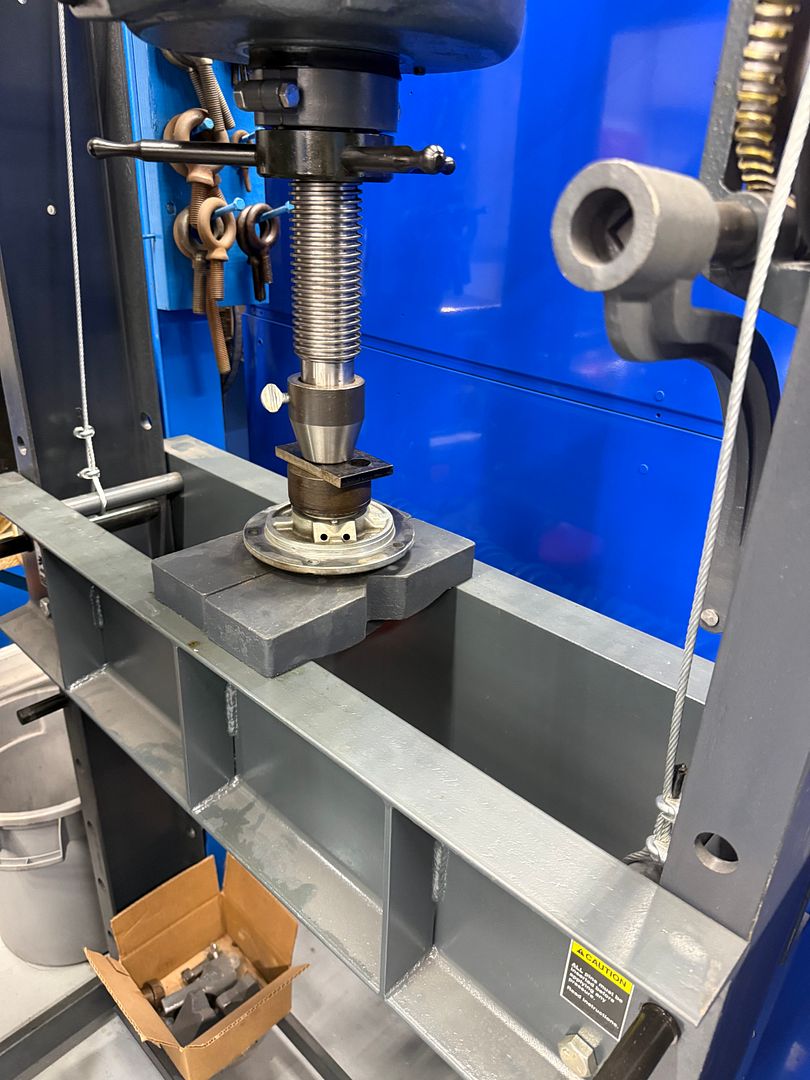

After replacing the Washer Reservoir in the Smart Car. It's back to the old Ingersoll Tractor. I installed the new main bearingh into place using my Dake Hydraulic press..
