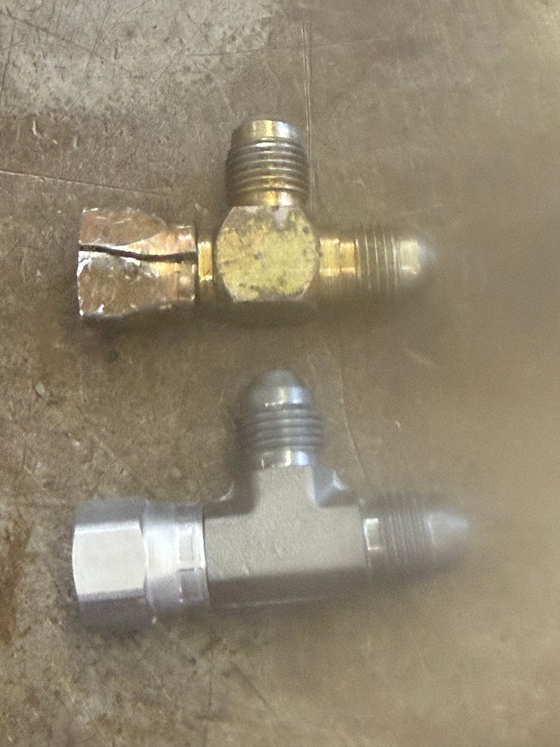

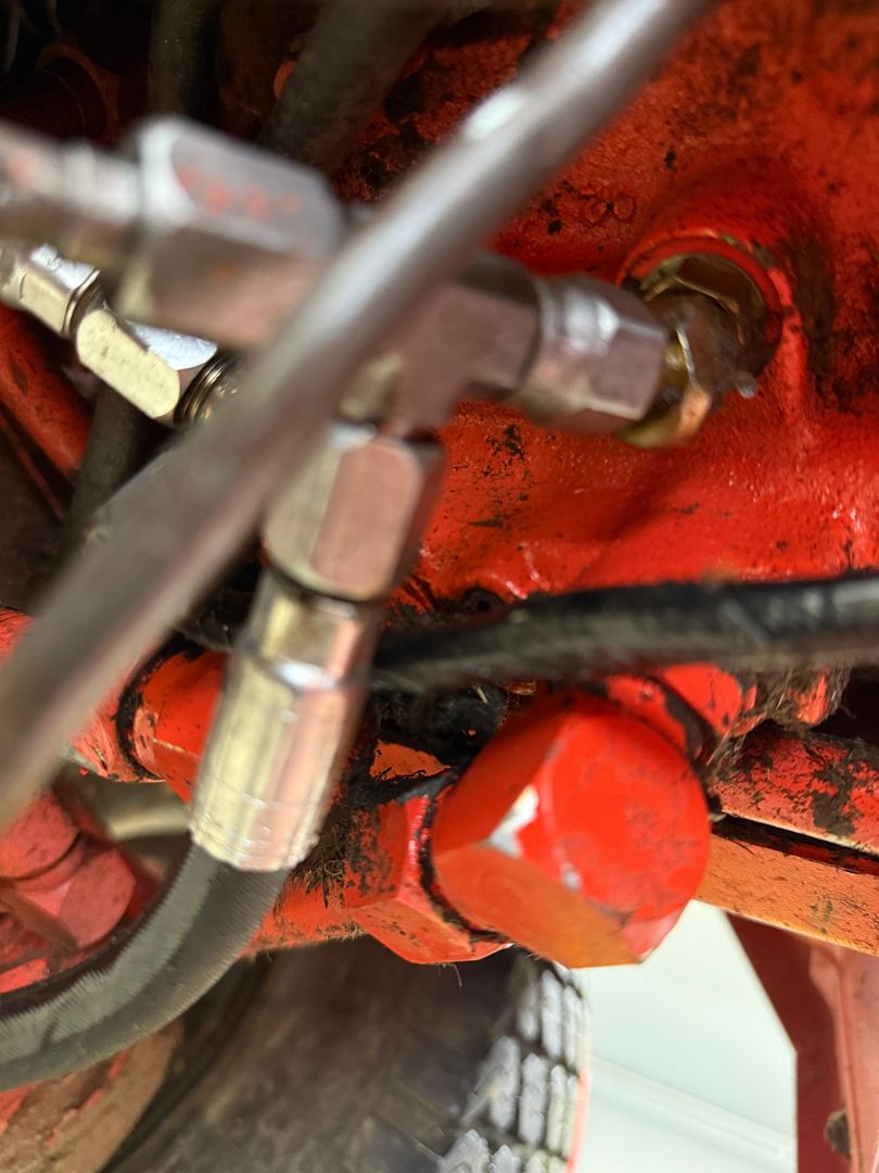

I finished putting the old gal together today. I have to report she started right up and engine runs perfectly. But noticed a bad oil leak coming from the underside. The leak was coming from a JIC right-angle fitting. Snugging the female swivel side of the fitting didn't stop the leak. After removing the fitting I found female swivel cracked.
Picked up a replacement fitting. And installed a it... Leak solved.

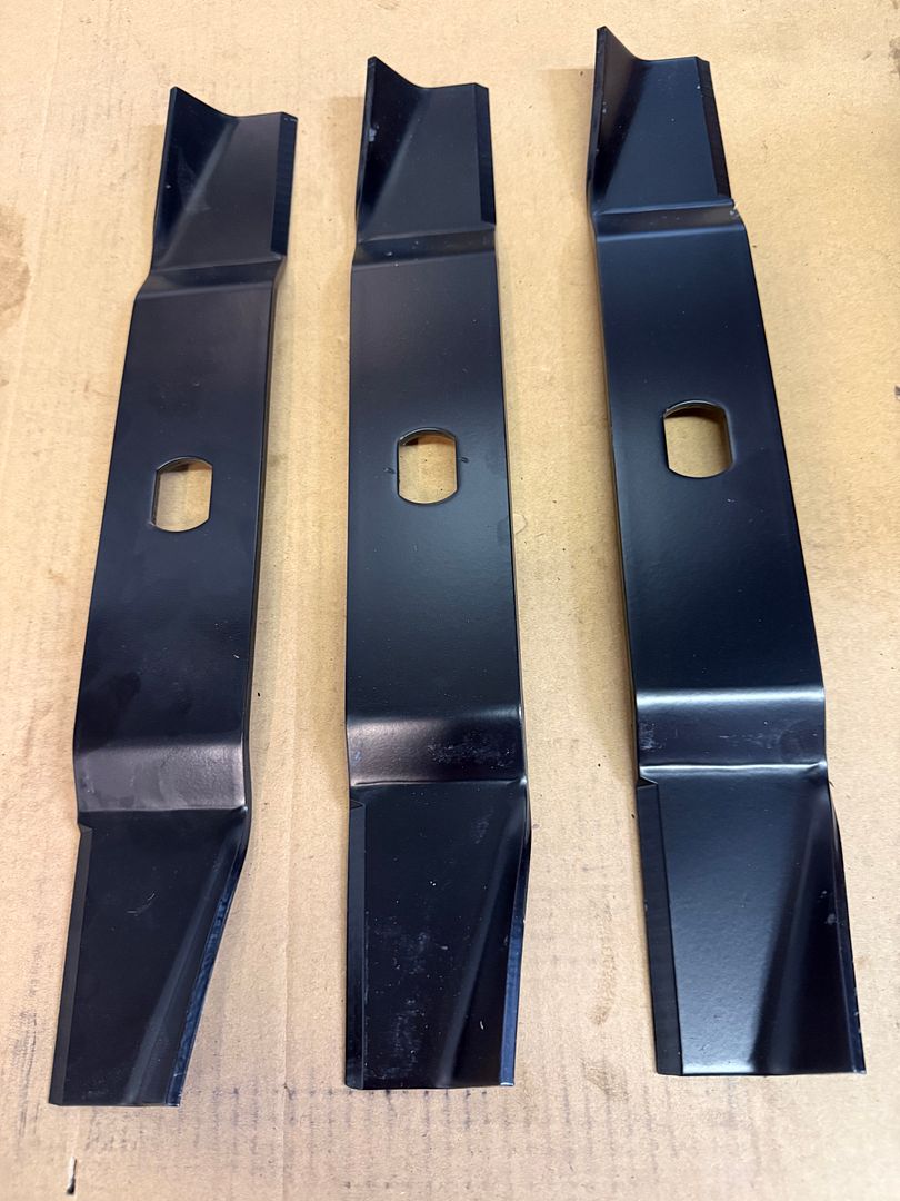

While the tractor was on the lift. I installed three new blades..
