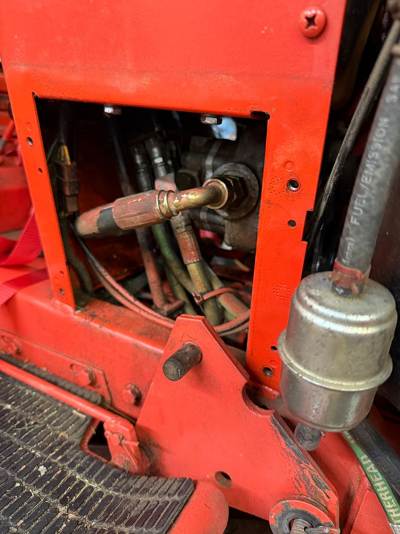

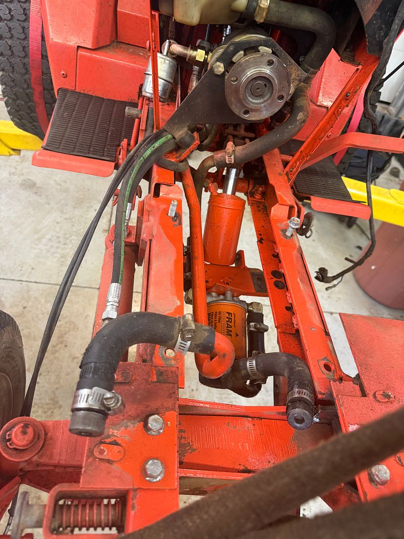

Over the past six week and several hundred hours, my Ingersoll performed like an absolute dream. This week all things hydraulic shut down, No power to the wheels, deck shut down, and no power steering.. But the engine kept running. Sadly I was caught mowing at the far end of my property. And towed it back to my garage with my baby Deere Tractor. Once on the lift I could see that the pump shaft was not  turning while cranking the engine..

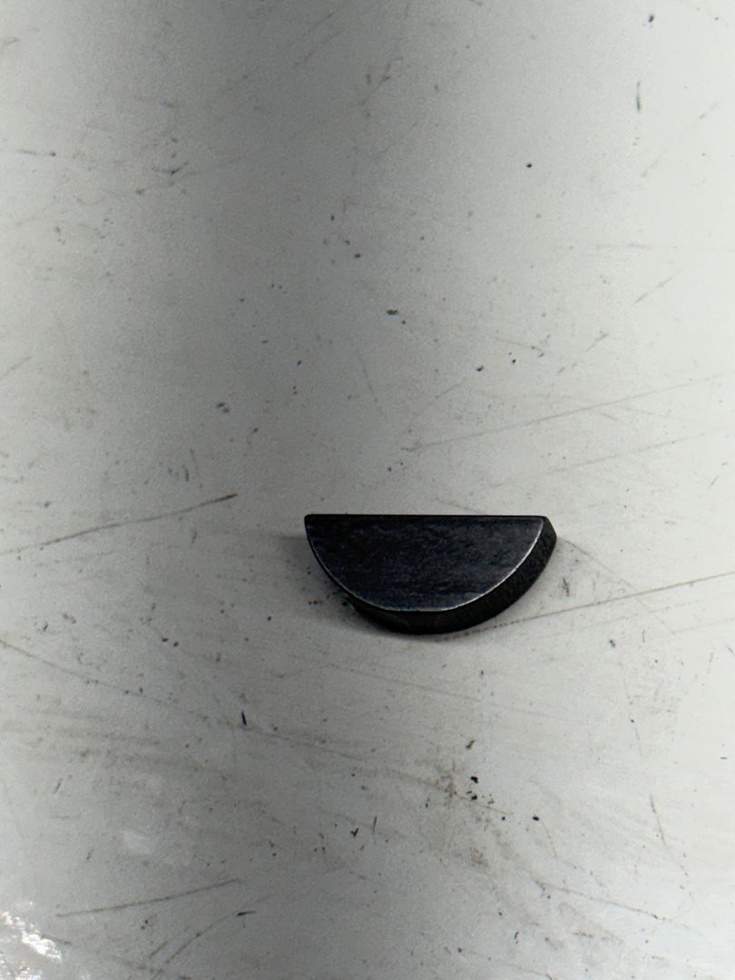

Rather than removing the entire engine again. I removed the four screws that attaches the pump shaft flange to the engine. Then removed all the pumps hydraulic lines, making enough room to remove the flange from the pump shaft... There are two set screws on the flange, 90 degrees apart, with  one directly over the key. There was no Woodruff Key!  I'm certain the tractor ran 35 years with only the two set screws. As the woodruff keyway was packed with dirt and grim. Fortunately I have hundreds of shaft keys, including Woodruff style.. Reassembled and is now runny again...
I never removed the adapter off the pump shaft
Tight quarters to remove hydraulic lines to move pump from the adapter
Wooddruff key
