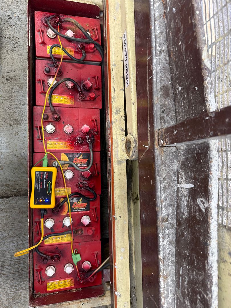

My scissors lift has six batteries hooked in series and runs on 36 Volts. When not in use, I use a Granite 36 Volt "Battery Saver" that's a changer/maintainer and does the job. These batteries are over 15 years old and still ticking. Always keep the batteries topped off always with distilled water..
