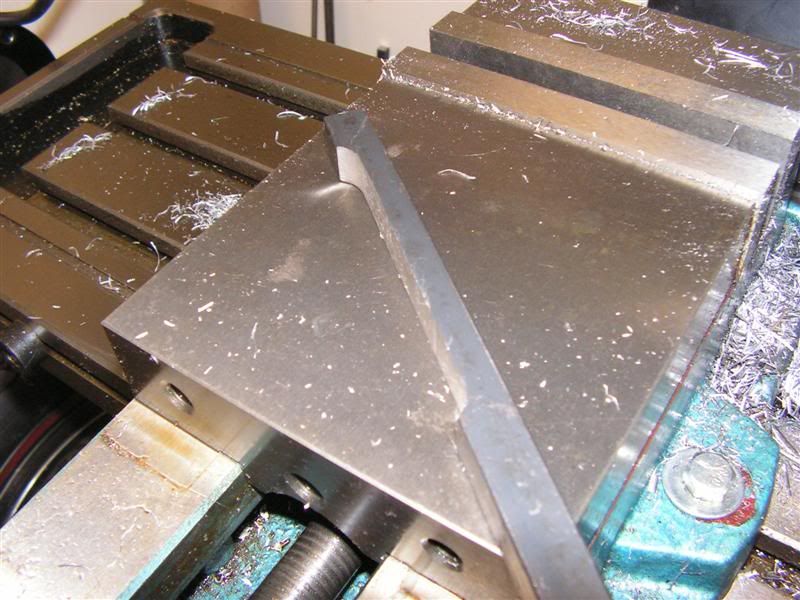

Look close at the previous pic, because here it becomes tricky!! Since were using TNMA inserts we need a 5 degree offset (just like in the other holder), but this time at a 60 degree angle. So we will need to machine a compound angle. To accomplish this I used an adjustable machinists vise. Unfortunately I forgot to take a pic while machining -- but here is a pic of this vise
Set one axis to 60 degrees and then tilt the vise 5 degrees for the relief angle -- voila -- you have a compoung angle for the rake.
here is what it should look like -- 60 degrees sideways and 5 degrees tilt.

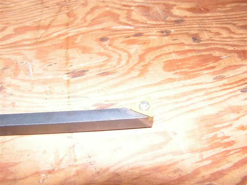

This cutter will have an insert on each end -- hence a dual use roughing tool. One side will be for boring, the other for smoothing

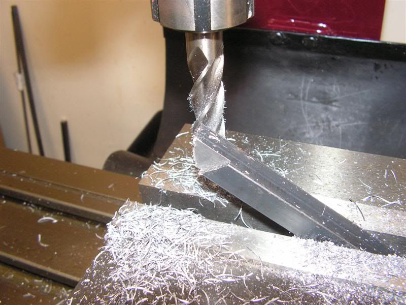

As before I simply mark the square bar with the position of the insert in order to mill the seat pockets.
The insert is then fastened in place with a simple nut and screw
Once the insert is taken care of, the bar is milled to make 6" extension

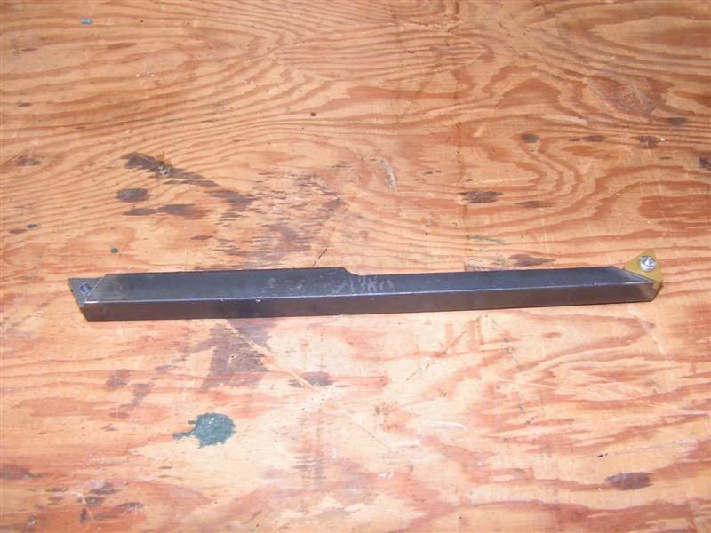

Nothing fancy -- here is the finished bar. No compound angles to worry about, just a straightforward flat milling task.
For the price, it's worth the 45 minutes to an hour to make one of these things.
