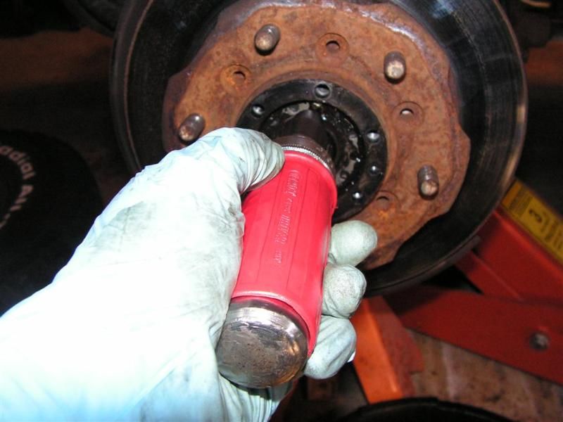

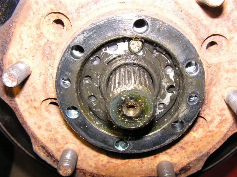

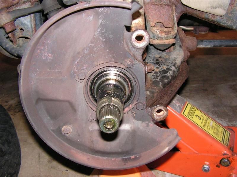

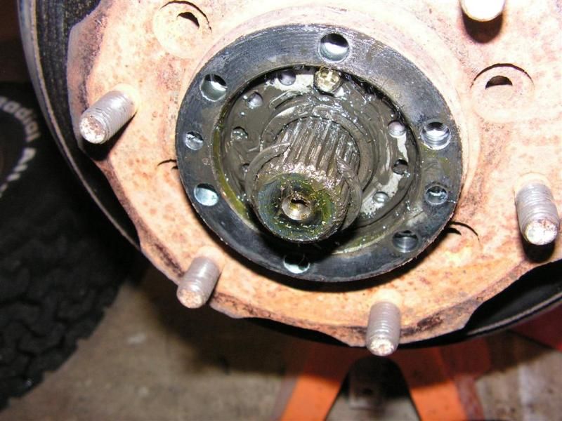

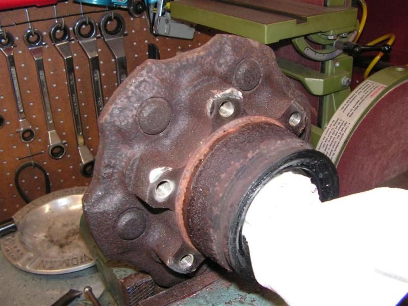

This truck has a lot of mileage and the rear brakes were in need of replacement; as were the rear handbrake cables. So the first thing to do is get the brake drums off. Easier said than done, because the shoes may be stuck to the drums, or have cut a lip unto the inner drum lining making removal tedious. First, there are usually two tapered screws that hold the drum to the hub. In the first pic below you can see one of the tapered screw holes at 12 o'clock. These need to be removed. Then, the best thing to if the drum will not slide easily off the hub is to use a hammer and beat the outside, as well as the inside face of the drum.
