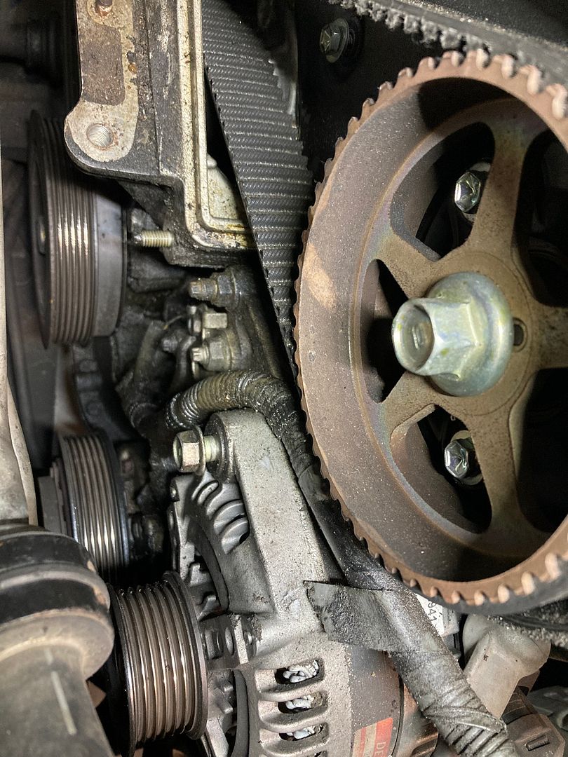

Next the alternator is loosened on its pivot bolt and the pinch bolt on the adjusting screw is loosened. Once the that pinch bolt is loose, the adjusting screw can be turned counterclockwise to to drop the alternator down and loosen the belt.

Remove the 10mm bolts holding the cover in place -- now you'll see why getting the wiring harness out of the way was so important. There is a timing belt cover bolt right to the firewall and you'll need a small 1/4" ratchet to get in there. With the harness in the place, this would be impossible.

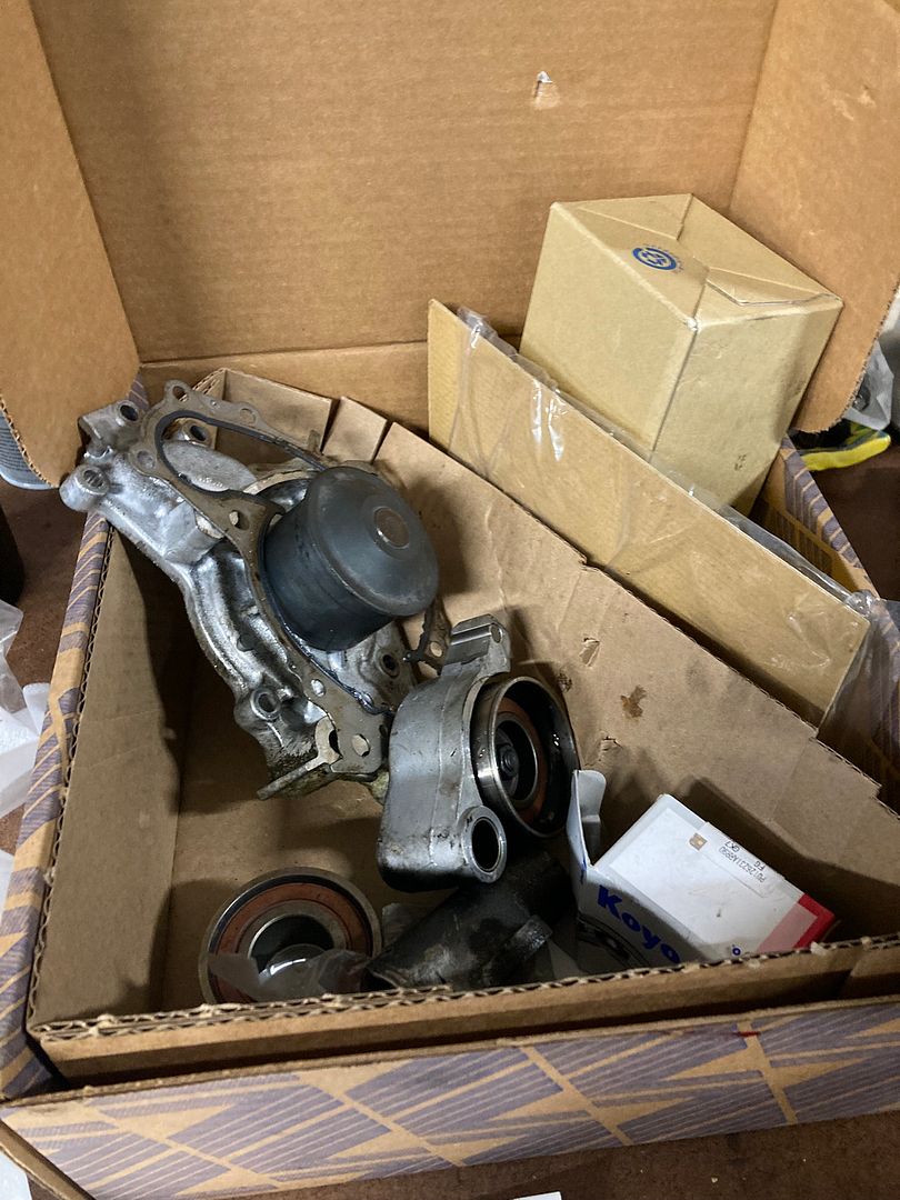

This is the kit I purchased -- Aisin brand. It's OEM Toyota and is the only way to go on these cars. The kit was $154 from Rock Auto and includes all the items needed -- Timing belt, idler, tensioner, tension idler, water pump. I purchased the accessory belts seperately -- AC/Alternator and Power Steering.

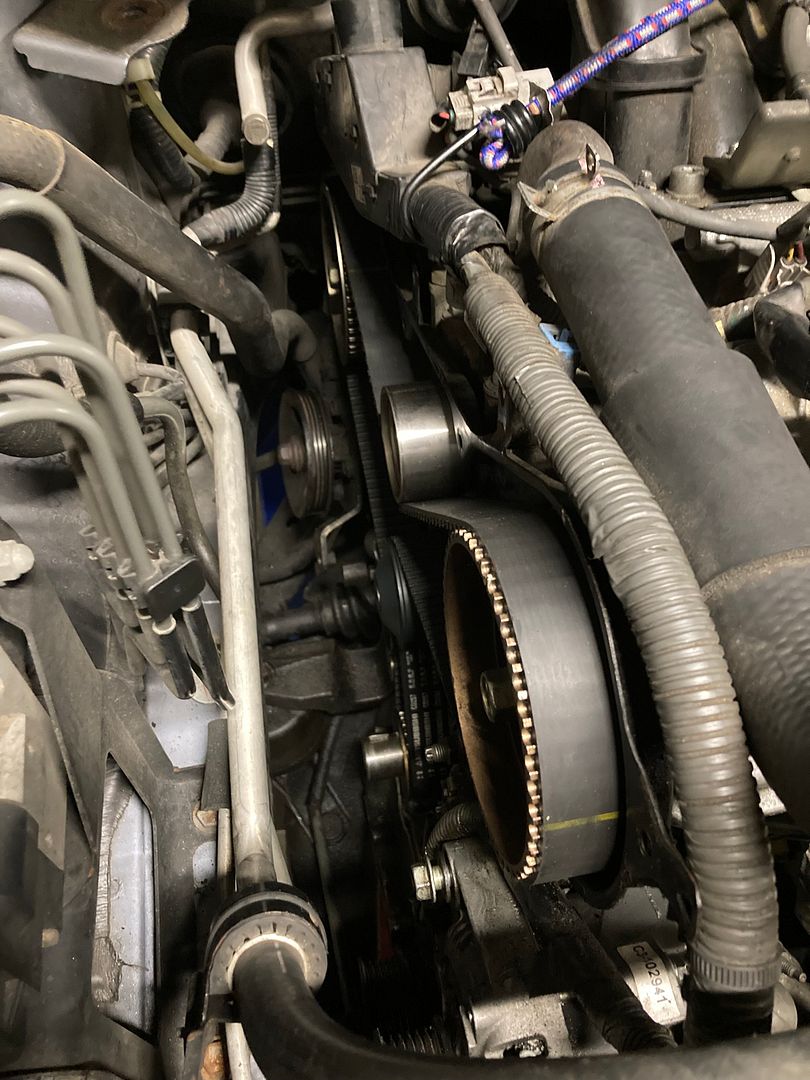

The timing belt is marked with the FR (Front facing) side and it also has three yellow alignment marks (two solid and one dotted). The solid lines must align with the camsprocket marks, while the yellow dotted line must align with yellow marker on the cranksprocket. I start with the rear camsprocket working outward to the front. Once I have my marks aligned I use some heavy clamps to hold the belts on the sprockets -- they can't move.
Although you can't see the dotted yellow line of the Timing belt, it is exactly aligned with the yellow marker dot on the cranksprocket -- at about 2 o'clock (where the blade of the screwdriver is pointing).
