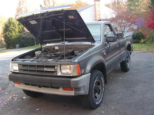

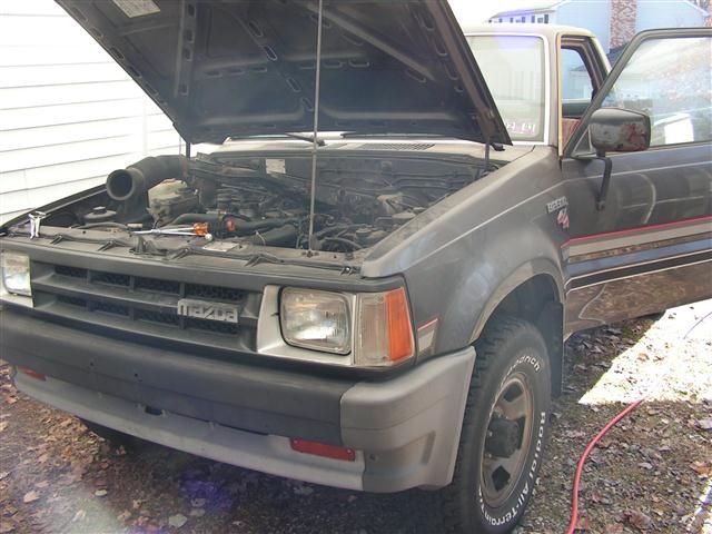

Finally got around to this truck. It needs a lot of love.  Everything is rusty, but some of the fasteners are still workable.

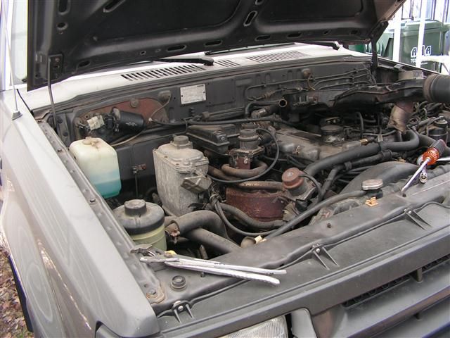

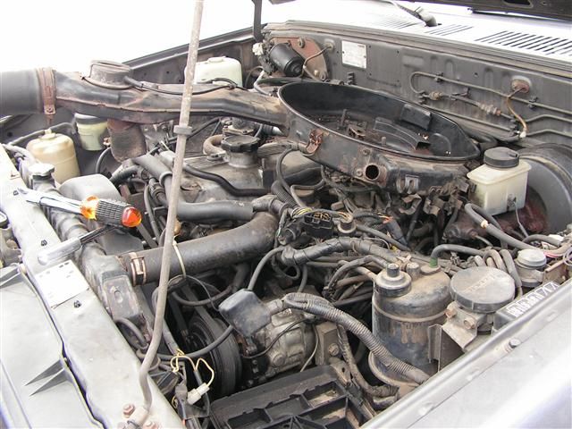

Surprisingly the radiator and condenser are in pretty good shape!

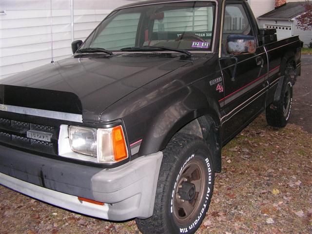

The front bumper is a mess -- rusty fasteners are holding it together; which means I'm not even going to try to take it apart for cleaning and painting. I will wash it, clean it, sand it and paint it as one piece.

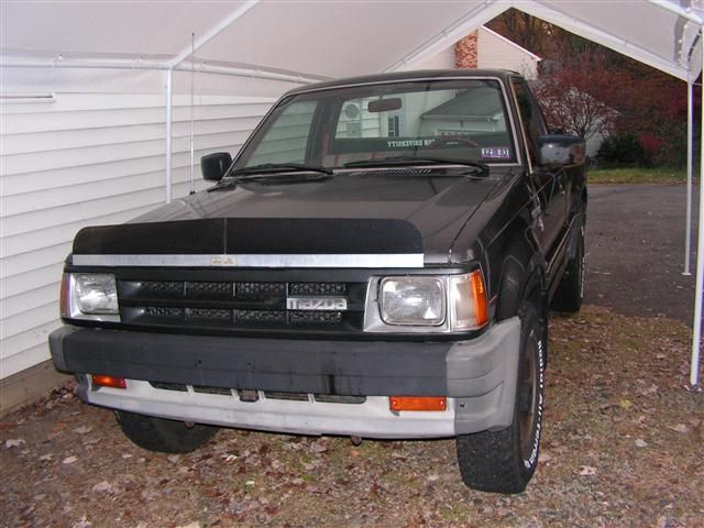

I used a solvent-based wax remover to get off the plastic oxidation, and then washed it with soap to open up the pores.
I then sanded it with 320 and called it day
This is Earl Scheib rattle can all the way -- The new stuff from Krylon has the primer and adhesion promoter already mixed in the paint. It's supposed to be the new choice for plastic and metal.

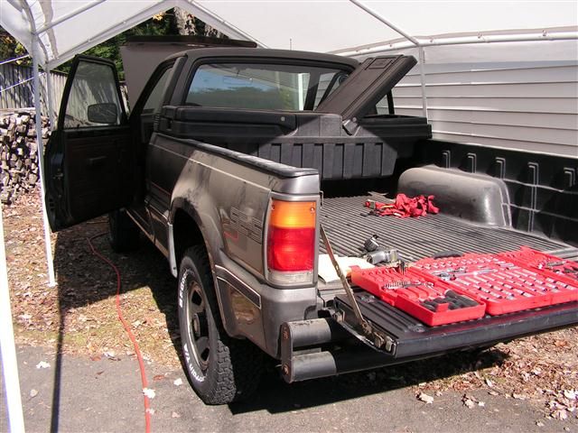

While is was at it I also removed the rear bumper -- totally rusted underneath, but I'll weld in a new section. Welding surgery will begin tomorrow.
Otherwise the rear looks OK

The rear bumper on this thing is totally gone. Time for a redneck rebuild. First I needed to dissect it to see what was still salvageable......
.... apparently not much!! -- LOL   -- RUST & RUST!!

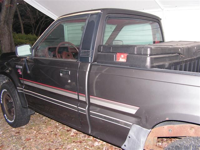

Made short work out of this one today. I needed to remove the toolbox, bedliner, sick-on decals and finally get at the rust in the wheel wells.
The toolbox has been on this thing since 1988 -- I put it on a week after I took delivery. Amazing that it still looks good and hasn't cracked or sagged. It, along with the bedliner were purchased at the local Montgomery Ward auto center at the time. Ahh, the good old days!!
Amazing what blows in under the liner in three decades -- LOL

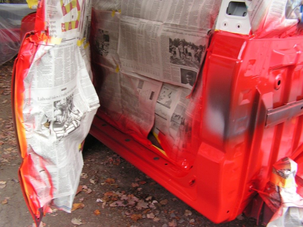

I laid down three coats -- one tack coat and two full wet coats.
After all that I had a very small sag on the right lower corner, but it evened out a bit while drying and noone will notice.  I won't even bother to fix it.
While everything was drying on the bed, I also cut in the fenders and cowl with red paint, and it was getting dark and colder I only had time to but in the drivers side sills with red.
By the time I was done with all that work, the bed had tacked up enough to uncover the job. I carefully peeled back the paper and tape to reveal the finished bed.
I LIKE IT!!!! It looks gorgeous. This is a true Chevy combination and the Ford Red is perfect for this job. It just "orangy" enough to make this thing pop.
