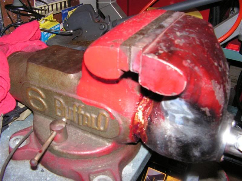

This is my 40 year old Buffalo 6" vise. Last week I was bending a big bracket and the casting let go at the body junction
The crack was almost completely around the circumference of the casting, so i just seperated the two with a hammer

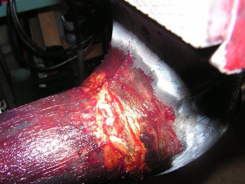

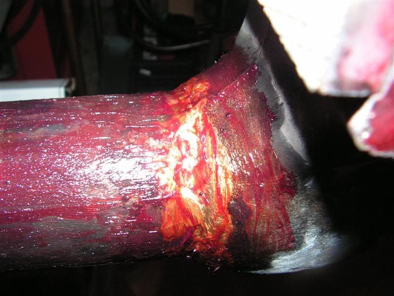

I don't have any pics of the interim steps, because of the speed requirement -- (since I was alone), but here are the pics of the finished brazed joint. The black/white "splotchy" areas are from the flux "burn off". Once the casting has cooled, it will be properly cleaned with a wire brush and the brass will be filed to a nice shine.

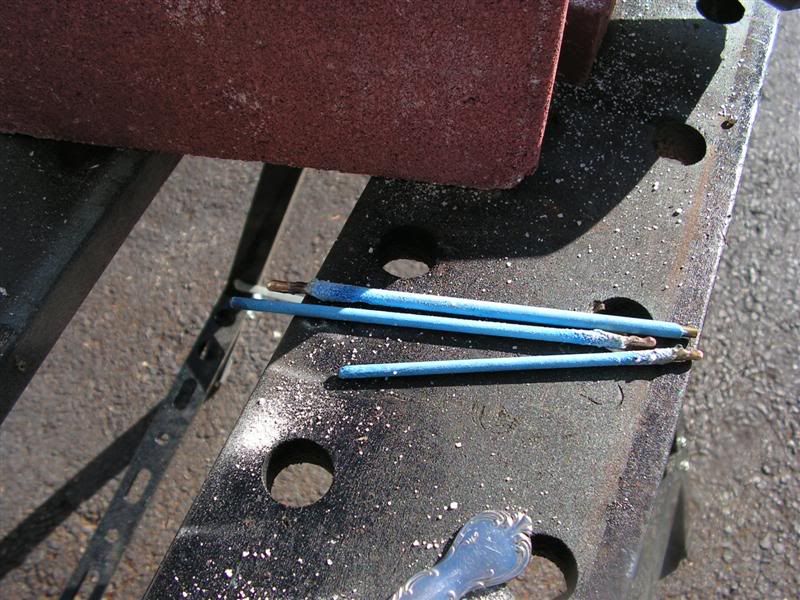

I used three 1/8" flux coated rods to complete this joint. This thing is not going anywhere soon  :toothy9:

The casting cooled down and here is the result after a little grinding and wire wheel work to clean up the brazing slag and "burn off". The ram was lubed and it works quite well again. I'll file it next week to make it more cosmetically pleasing -- but so far so good!!
No cracks!!! in the castings, and the brazed section is stronger than the surrounding cast iron.
I came home a little early from work and dressed the joint with a file and then lubed the entire ram -- It actually turns much more smoothly now than it did before  :toothy9:
