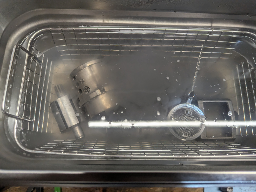

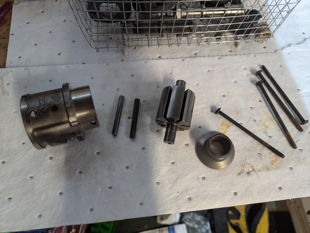

I've been thinking about picking up an ultrasonic cleaner for a bit now. Rebuilding this impact gave me an "excuse" to pick up this 6 liter one off the jungle website. (Amazon)
Seems to work pretty well. I think it'll be pretty handy to have.  I used a mixture of water, vinegar, dish soap, and some high proof alcohol. Worked pretty well. It did discolor some of the parts a bit but they cleaned back up on the wire wheel.
Anyone else have one? What solutions have you used?
