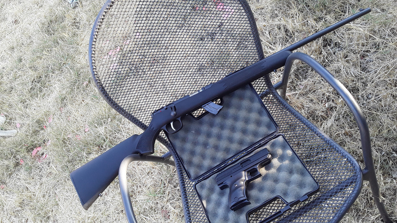

Awhile back I bought a Savage mk2 off my brother for $100 ( got a Hi-Point c9 too,$200 for the pair ).
It's a pretty respectable shooter, but I don't like all black traditional rifles or plastic stocks in general.

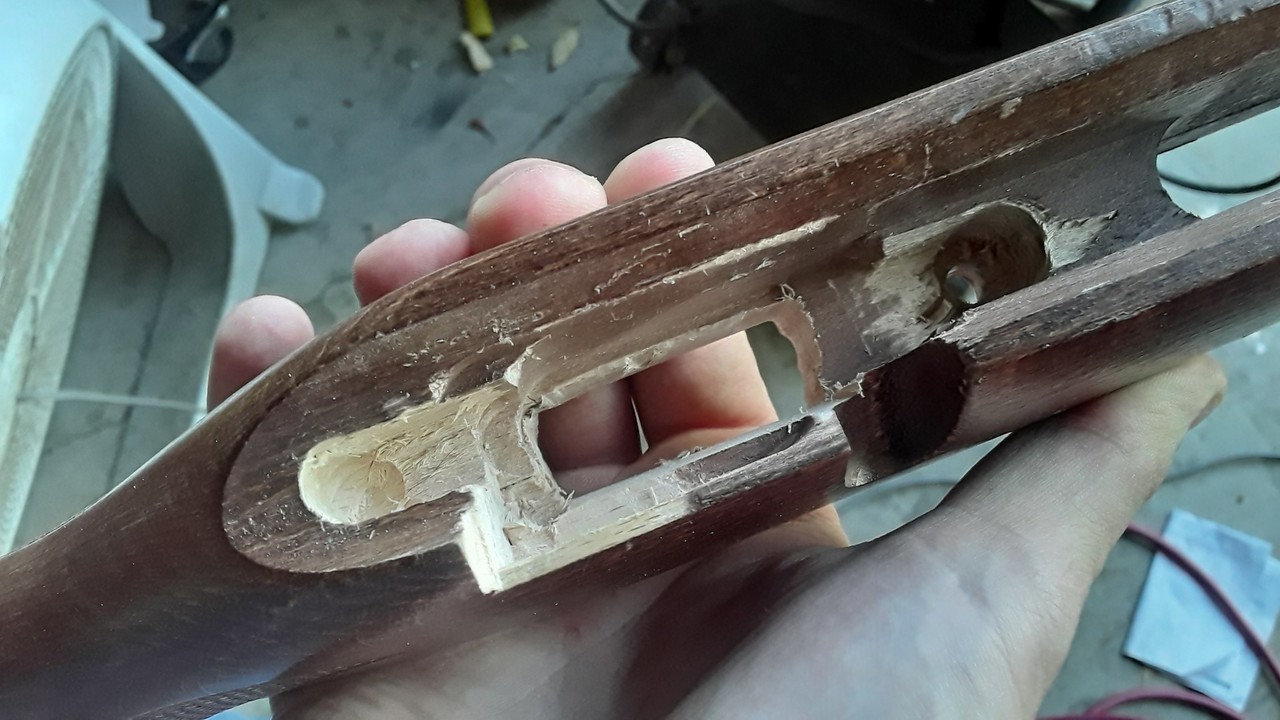

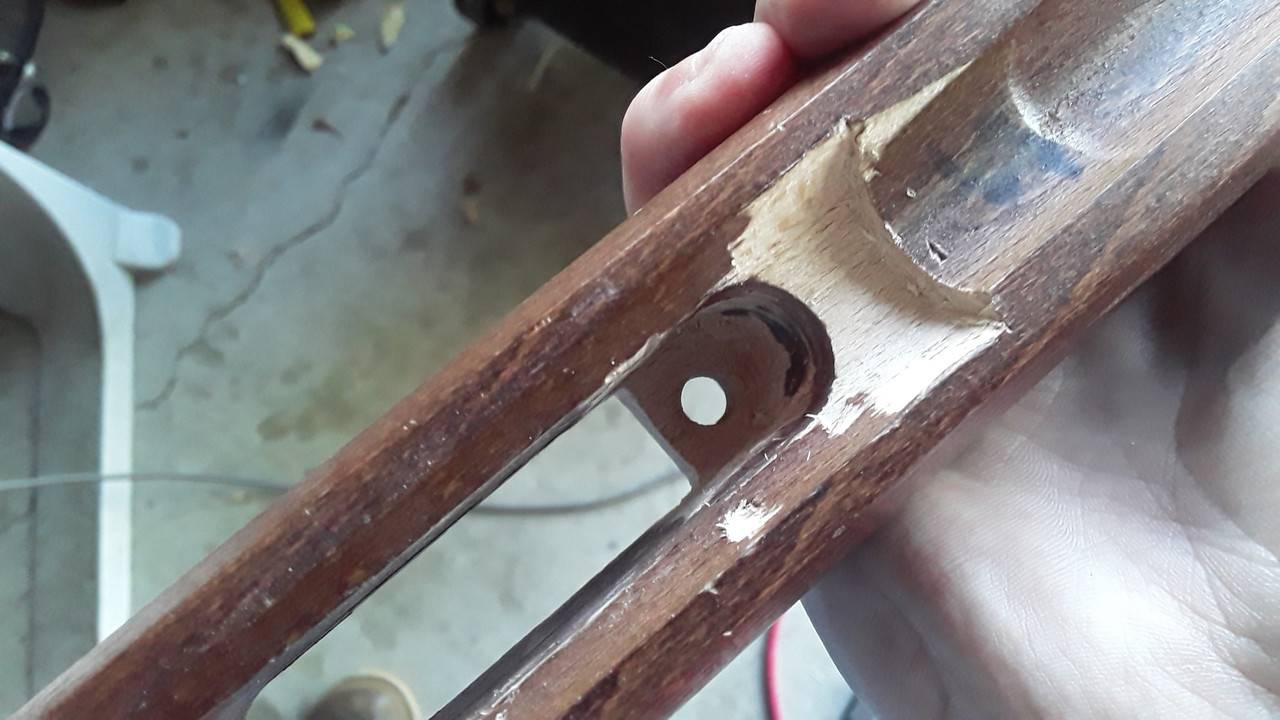

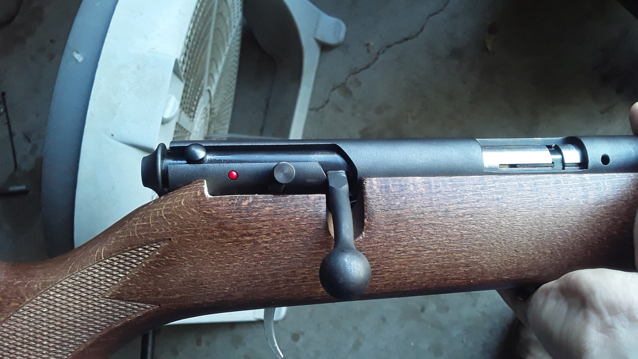

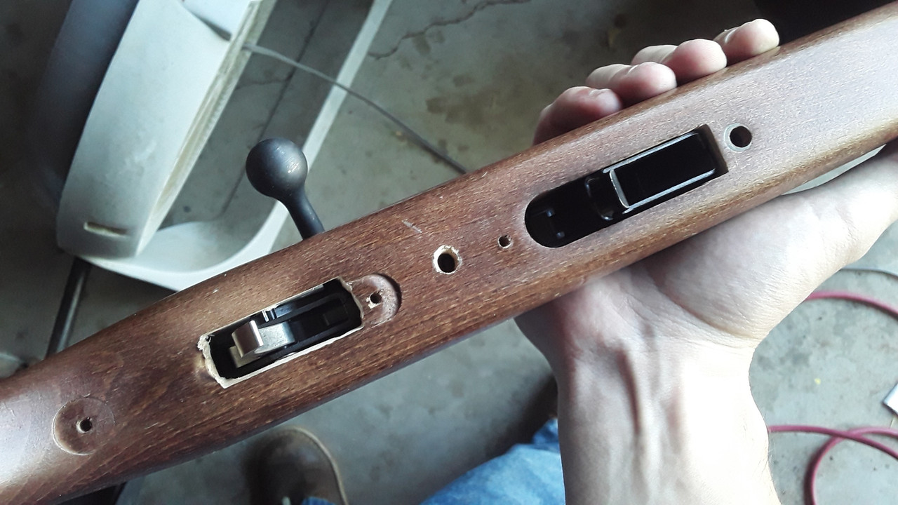

I decided to try and make the stock fit my gun, and I actually managed to succeed.
The work I did actually went better than I expected it to, most of it on the inside where it won't be visible thankfully.
It will need to be refinished, but I suspect this to be a cheaper wood that might not take a finish that well so I don't know what I'll do.
Here is the work I had to do.
I had to enlarge the trigger slot, because the trigger group housing has a flat spring and pin on one side that needs room.( apparently more changes were made to the mk2 than I realized.
I also had to extend the mag well slot.
I had to extend the relief for the safety and carve out a bunch on the inside for it and the whole fire control group, plus for the screw lugs as well as remove the middle screw lug which seems to be for a different stock option.
Inletting at the back here for the safety was scary as hell, one slip and I'd be blowing out a huge chunk of wood that I could never reattach properly.
And I had to extend the inletting for the receiver, it came out much much better than it appears.
Overall this work came out better than I thought it would and I proved that a previous generation stock for a savage mkG can be modified to fit a current production mk2.

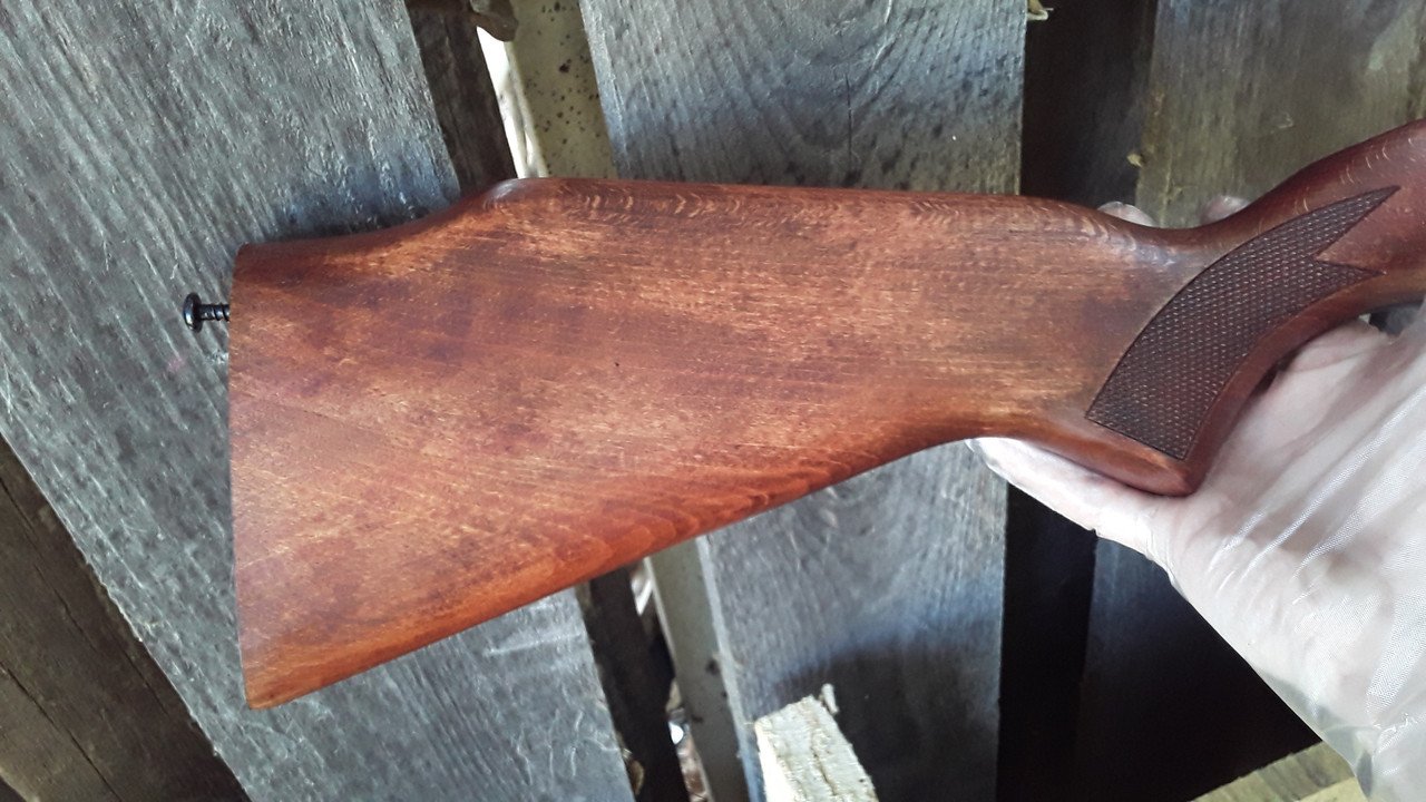

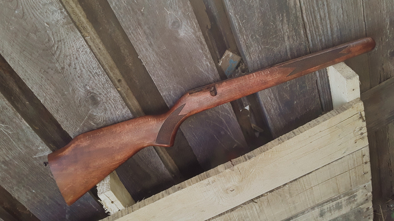

I had a bit of an adventure with the stock refinish work.
Scraping the top coat off with a cabinet card and razor blade went fine, but in sanding I could not get all the original stain out which might show.
I'd have liked to just leave it all for an even base color, bu none of the scars it had were candidates for Steam ironing out.
Masking off the checkering worked out fine at least.
The real problems came when I went to stain it, I keep forgetting that the  " gunstock " color from both minwax and Varathane sucks.
The picture on the label looks good but every time I but it I'm disappointed by how light and entirely ineffective it is.
Having no useful stain on hand and not waning to go buy more I decided to try using the RIT dye I had left over from a Case Barlow I re-dyed the bone handles on last year.
I knew people have used on stocks before it so I decided to give it a try.
It looked good at first but was mostly just built up on the surface, it was coming off and smearing around when I started rubbing in some watco.
I grabbed acetone to clean it off and ended up with some runs and drips that wouldn't come off.
After I was done getting the majority of it all wiped off, I tried a fresh rag with some more acetone on those runs and they weren't coming off because it had clearly absorbed into the wood.
Now I don't know if this was a good idea or not, but since the acetone had clearly helped the dye soak into the wood I decided to try mixing some Rit dye and acetone together.
I had to be careful to keep everything nice and wet so the dye wouldn't start to build up on the surface from the acetone flashing off so quickly but it did work.
I used a combination of a chocolate brown and a little red wine , and ended up with the exact color I had in mind.
I probably should have mixed the dye with water or something, I will look into the process people have used.
I ended up making the stock look old-ish which was not my intention,  but I think it'll probably look alright with enough light coats of watco rubbed in.
